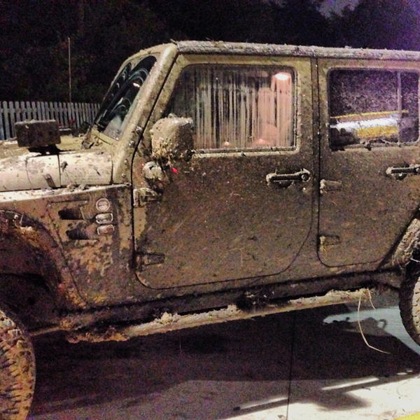

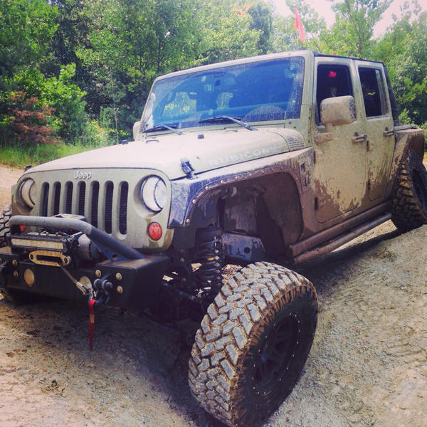

I have the armor on the front and the rear. I love it! It is really strong and looks great! The only downside is that there is very little tire coverage.Click image for larger version

Originally Posted by TH3APPL3GUY
I have the armor on the front and the rear. I love it! It is really strong and looks great! The only downside is that there is very little tire coverage.Attachment 502551Attachment 502552
I thought about that when i bought mine but if you look at the steel support on the stock bumper ( front ) it only extends a little bit on both sides of the frame so the stock steel core support pretty much affords no protection for the wheels either. You only have the plastic pices that extend all the way out and they are so flimsy im pretty sure they afford no protection of any kind against any real impact. The rear bumper is entirely made of plastic so anything made of metal is pretty much an upgrade lol.
Old Oct 4, 2013 | 11:06 AM
TH3APPL3GUY's Avatar
Posts: 130
From: Indiana
The fenders are made of steel..
