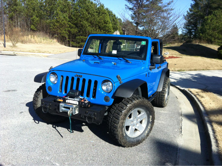

Use plasti dip. It blacks then out and you can still see then. They also make a smoke color that is translucent.

Both of those "then"'s were suppose to be "them" oops haha

Did you do the rear lights too?

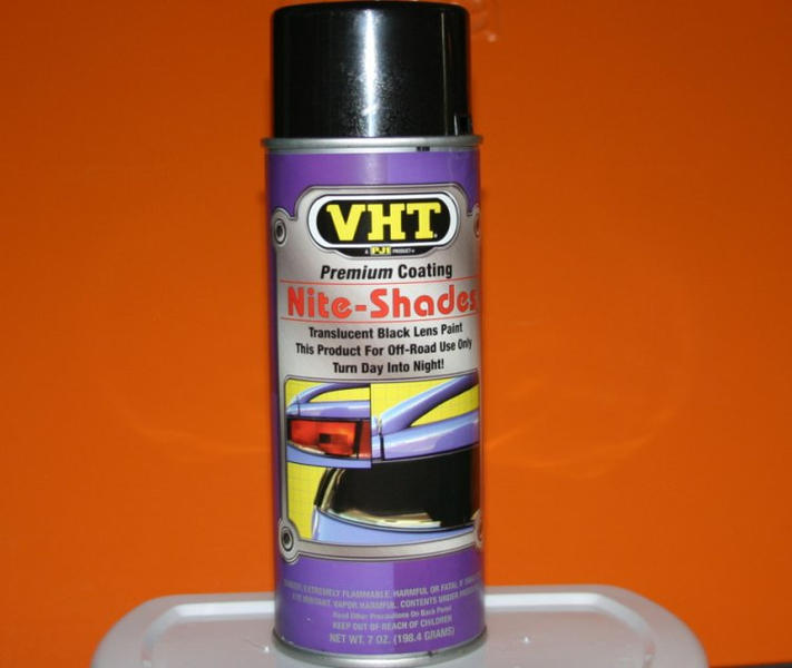

VHT Night Shades seems to be popular.

Ummm, don't use PlastiDip!!!
VHT Night Shades is what you want - it's a translucent paint
Works awesome! I'd say about 3-4 light coats does the trick. If you go too dark, just use some acetone to remove it and try again

VHT Nightshade sucks too. It's not very glossy. Looks kinda milky. I use DuPont clear with a little black basecoat mixed in. About 10-1 clear/black. Then pass it till it is desired darkness.

Thats exactly what I am looking for! Those look good!
