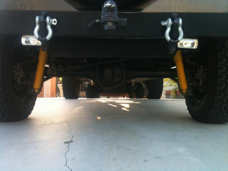

Old May 20, 2012 | 05:22 PM
IndyChavez's Avatar
Posts: 389
From: Downey ca
Yellow ones look cool and ride good!
