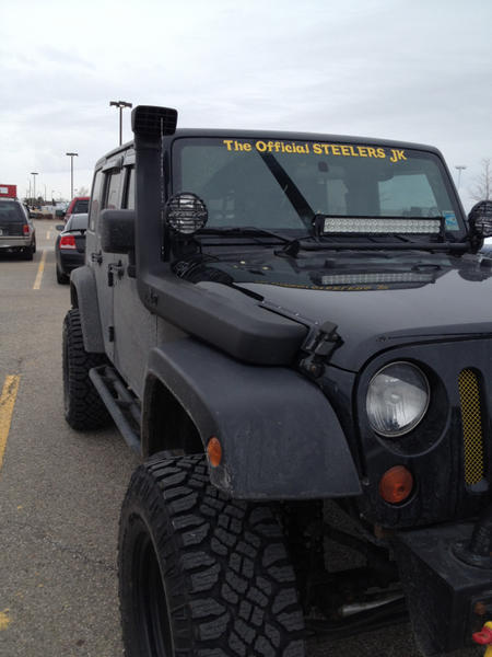

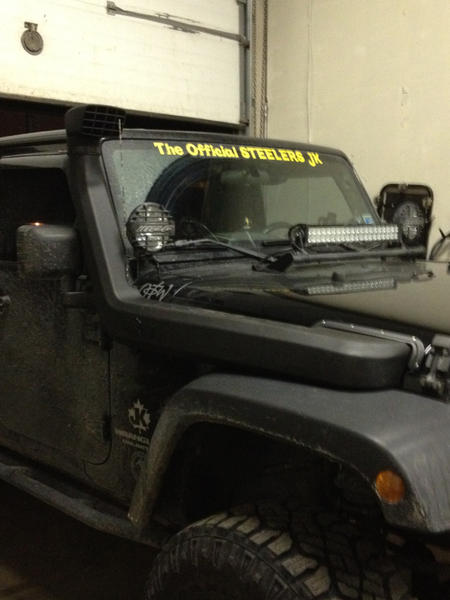

OK LADIES lol don't think anyone's answered the OP's question tho!!!
I used a 2" hole saw to start and then an angle grinder..... worked just fine
I'm still in favour of look at my jeep it has a snorkel.... I went AEV GEN 2 snorkel

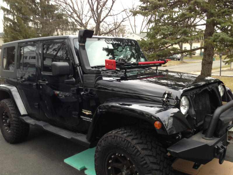

I have just installed the AEV on my 2011 Diesel: used a 2" hole saw for the corners and a Dremel cutting wheel for the straight part (AEV Snorkel on Black Boar | Black Boar)

De 2nd gen AEV works for both the petrol versions as well as with 2.8 CRD Diesel version.

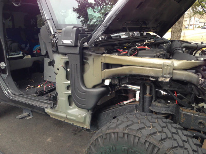

...Hardest part was to taking Wipers OFF ...Install was very simple w the provided instructions ...
