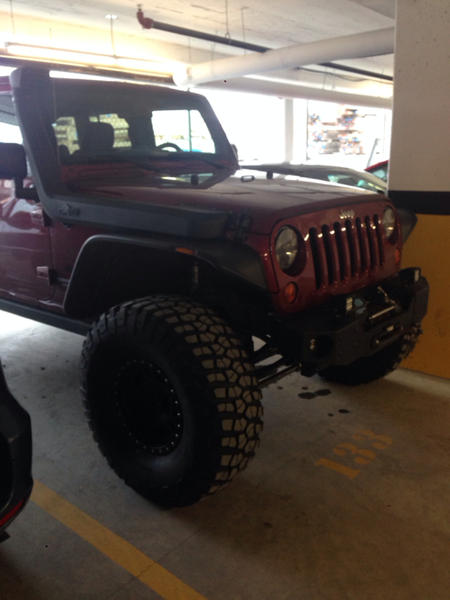

Got my supercharger+snorkel combo. Love it and im glad i got it. Decent crossing on my last trip that surprised the whole crew. Mud and water up to my doors and you had to move quickly to keep your momentum going. Found mud and water high up in my engine bay. Without the snorkel my supercharger would of no doubt sucked up some water.
