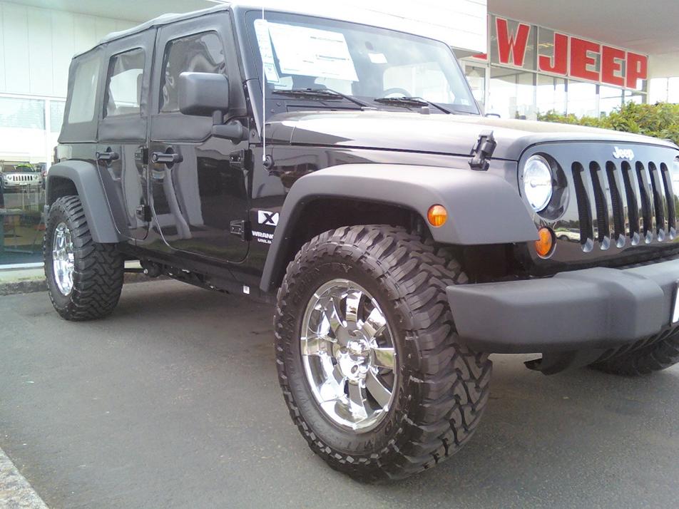

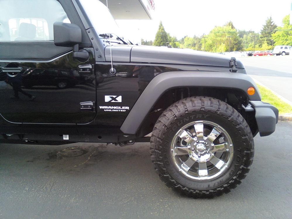

I saw some 33x12.5r18 on a wrangler at the dealer ship and it was what i wanted but are there alternatives? Will 285 wide tires on stock rubi/sahara rims stick out at all?
here is a pic of the one i saw at the dealship, I like the tires and not sure about rims.

Are you using the stock rims? duhh i didn't read all of it... I am not a big fan of spacers either... I'm pretty sure the stock rims have around 6 1/4 1/2 BS. Are you lifting it? I think 33x12.5 will rub a bit if not lifted or leveling kit. It also depends on how wide of rim you get... I have 35x12.5 on a 10" rim with 4.5 BS and they stick out about 2" its a bit much but i like it! I'll post a pick...

With spacers the 275/70/18s on a stock rim will stick out a bit, so I'm sure the 285s and 295s will also.
