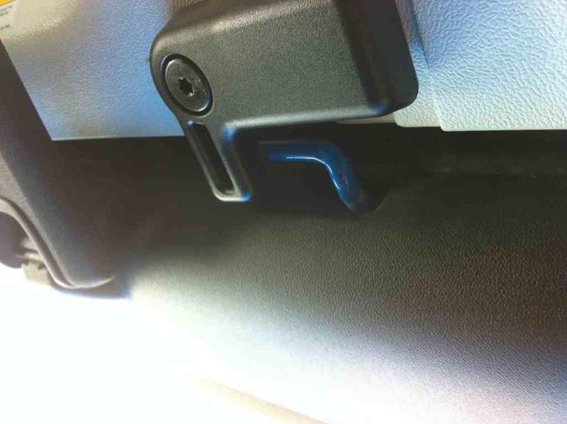

The center hook thing for the hard top along the header is in a slightly different place on the older Jeeps. I have a 2008 top on my 2011 and had to notch out the header part of the soft top for it to close properly. You will probably have to do the same.
Old Mar 26, 2013 | 11:58 AM
ballsdeep's Avatar
Posts: 390
From: Albuquerque, NM
This part.
