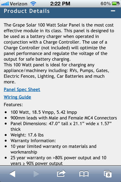

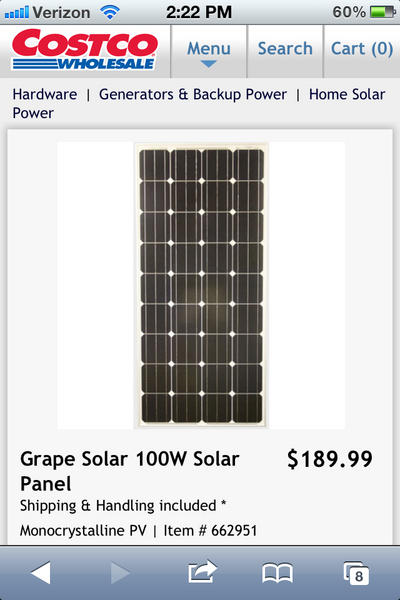

I recently looked at Costco website for solar panels and I think this might work for you. Looks like it would have to be mount on the hard top or roof rack. I dont know if it comes with hardware or not. Hope this helps!
