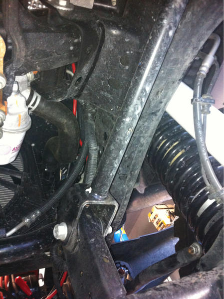

I have been trying to figure out where the northridge4x4 grade 8 bolts go. All I've gotten is control arms and track bar. Problem is I don't know what those look like. I've taken a bolt out and now the pieces don't line up anymore. Everyone said this was easy just take a bolt out and put the new back in.

Old May 18, 2012 | 05:09 AM
Indy08jk's Avatar
Posts: 87
From: Fishers,indiana
Have someone rock the body side to side or turn your steering wheel it will go right in.

Old May 18, 2012 | 05:16 AM
keithsfd7's Avatar
Joined: Aug 2009
Posts: 244
From: Sparta NJ
Use ur jack to either lift the axle or the frame slowly to align the holes
Old May 18, 2012 | 05:20 AM
Duradak's Avatar
Joined: Aug 2009
Posts: 135
From: San Jose, CA
Ratchet strap from the body on one side to the axle on the other.
Old May 18, 2012 | 05:30 AM
Wgrin's Avatar
Posts: 741
From: Watertown, NY

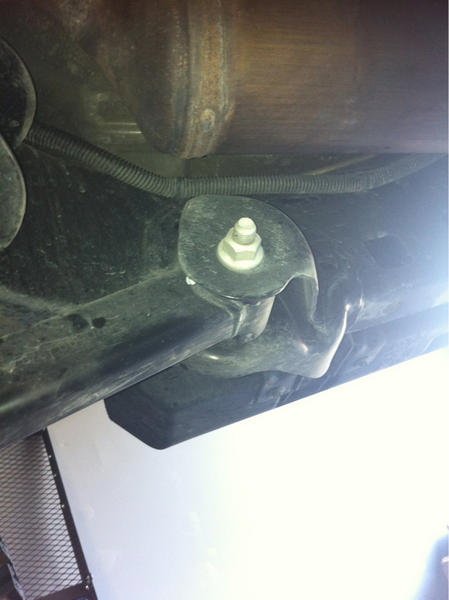

Ok thanks guys got it in, did a little Speed movie set up, put a crowbar in between the steering wheel to hold it still.
Now....
I've been tightening this with my torque wrench to 125lbs it isn't clicking but the bracket is starting to look like its bending
and true bolts turn with aid of wrench
Wgrin's Avatar
Posts: 741
From: Watertown, NY
Is this done to the other end too?

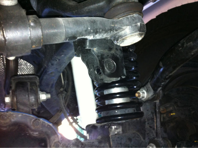

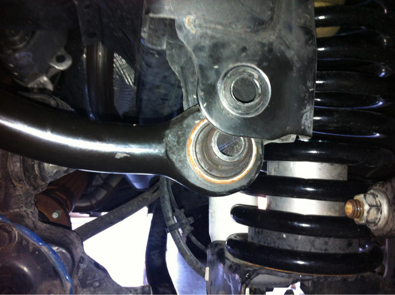

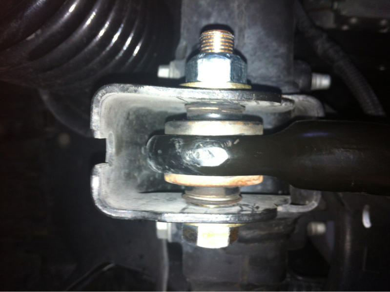

Old May 18, 2012 | 05:35 AM
Wgrin's Avatar
Posts: 741
From: Watertown, NY
Since I have everyone here should I replace these?
Thanks

Old May 18, 2012 | 05:52 AM
Wgrin's Avatar
Posts: 741
From: Watertown, NY
Originally Posted by mpkelley20
Swapping out the lower arm bolts is very easy assuming you are not changing the lenght of the arms (if you had adjustable). Just do one side at a time and no need to jack the Jeep up. They should line up very nicely with the holes when you are reinstalling. If not, the long screwdriver idea works very well in that situation to pry them to line up.
Appreciate it last thing in my pics which is the lower control arms? The bigger ones or smaller? And do I change both bolts or just the lower (altitude) ones?
Old May 18, 2012 | 05:59 AM
finnd1's Avatar
Joined: Jun 2010
Posts: 1,465
From: northern virginia
I bought the same kit and it had 4 track bar bolts (so yes to both ends of track bars) which I used and 8 control arm bolts (all lowers) but I could only use 4 on the frame ends as my RK control arms use a 14mm bolt for their axle joint ends.
yeah, that was a nice little surprise after getting the bolt kit from Quadratec to find that I couldn't use them with my RK LCA's
