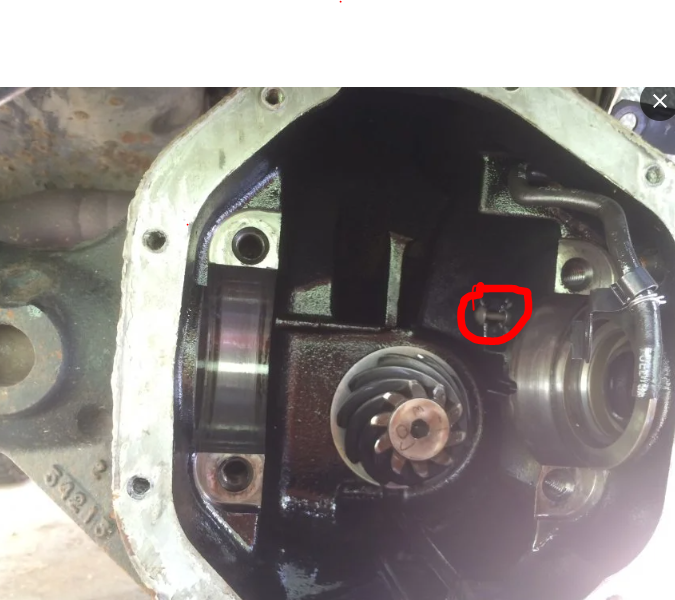

Originally Posted by cosmojk
Yeah they said the locker actuator was in backwards. Idk if thats true but that's what they said...
That is impossible they're just making shit up now. Odd. I would have like to know what it really was. For what it's worth, this is the locker actuator right here -
Sorry I meant the actuator sensor - would that cause it to bind? They said it was an aftermarket sensor but I went to an off-road shop sometime after and they said no, the one I have installed is OEM. 2010 JK rubi

Nah, that makes no sense either. The actuator sensor is this little guy right here, and it just slides back and forth as the actuator ring is engaged or not.
Those things can bend if people are not careful reinstalling the carrier back in the diff, but they can't cause any binding. The only scenario that i could picture that is if the head broke off and was getting tossed around in the gears.
I guess this one will remain a mystery. Good thing is you're rplling around with no issue again.
