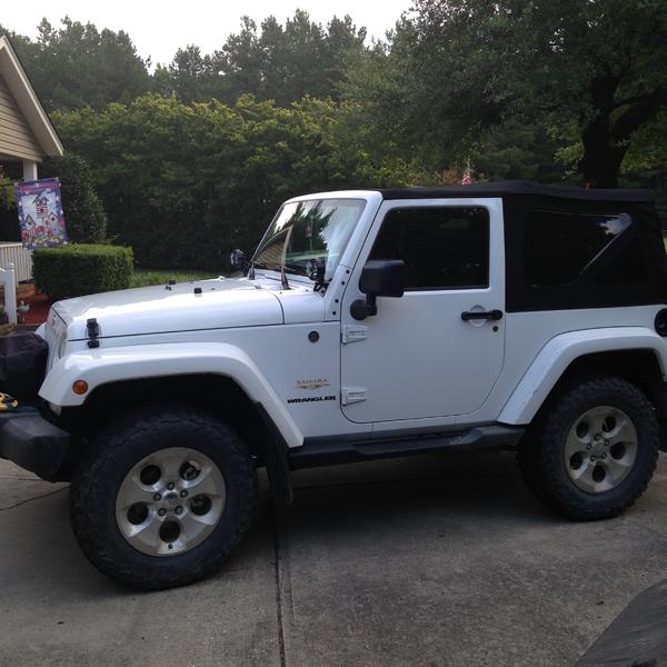

This is my set up with the 275/70R18's (33X11) with a 2" Rancho sport lift w/ RS9000XL shocks. Pictures from Uwharrie soon to come.
ID:	562936Click image for larger version
You can see after it settled I ended up with more than 2" and there is NO problem stuffing those 33's. Rides better than stock on the road, and the tires are as quiet as the stockers.

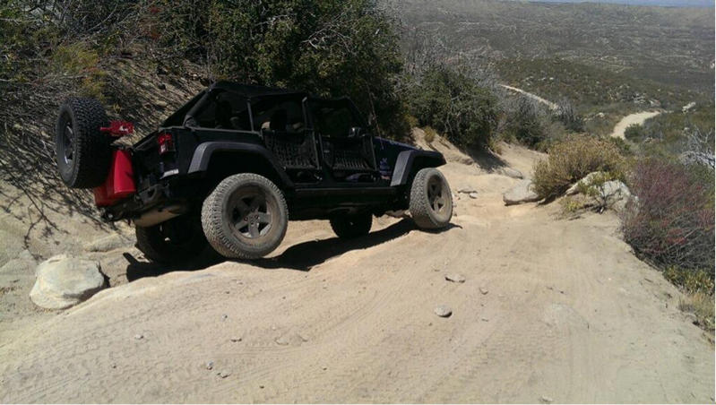

Here is my set up with 34"bfg some say they are 35's but under load they measure out at 33"
2.5" TF bb with the shock extensions. I did also get some rc quick disconnects for the front and the TF exhaust spacers. Other than that suspension gearing 3.73's is all stock.

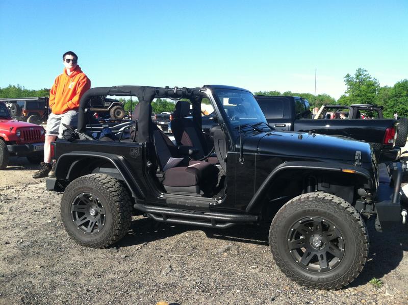

Here's mine with 33s and a Rock Krawler leveling kit and Bushwacker fender flares.
