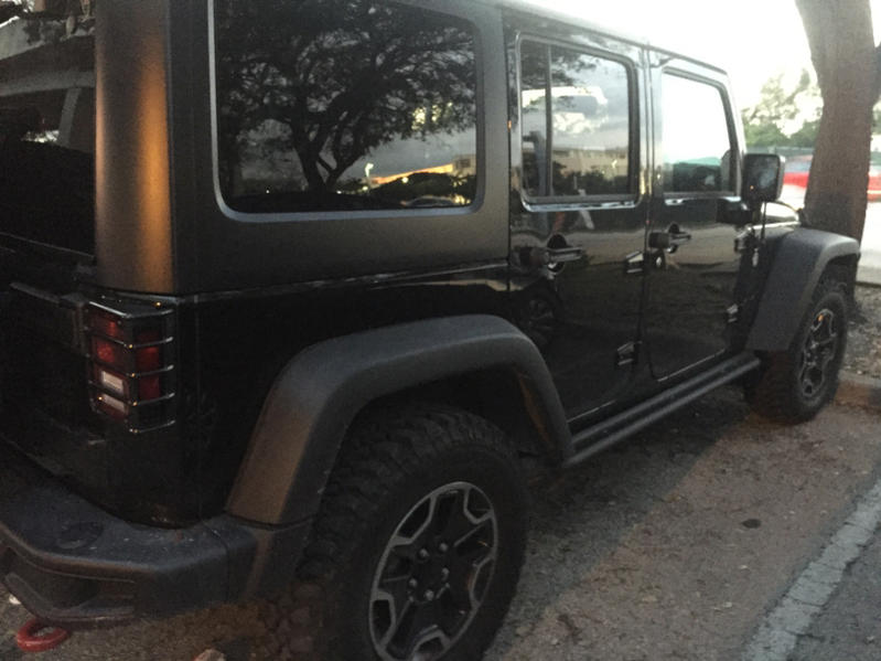

Hey everyone,
Literally just signed up to this forum. I just got my first wrangler a couple months ago and I have been doing a good bit of research independently but I'm seeking a little guidance in terms of modifications. Hoping to avoid bias from the various shops around town.
My sister has a 2012 2-door Wrangler but I just got rid of my '06 Cherokee and got myself a 2015 4-door JK Rubicon.
I like the wheels & tires it came with, but I'm looking to beef it up a little bit. I plan to get some 20" KMC-XD Rockstar II's on some 35" Goodyear Wrangler MT/R Kevlar tires, and plan to put the old ones on my sister's Jeep.
I know I'm going to need a lift, but this is going to be expensive as it is, so I was thinking of going with the AEV 2" spacer lift (about $250), since the rubicon already comes with good suspension, as opposed to a suspension lift ($1200-2500).
So what I'd like to know from you all is (answer any you can, hopefully I can get all the answers collectively):
1.) Would you recommend going with the AEV spacer, or saving up a little longer and change the suspension?
2.) Would my sister need a lift to accommodate the Willy's wheels with the 31" tires mine comes with?
3.) Is there anything make or break about the Kevlar tires?
4.) If I do go with the AEV spacer, is there anything I should keep in mind about the ride?
Thanks in advance, I hope y'all can help initiate me into this new culture I've found myself in
-Chief
(Not the best picture, I assure you, but for reference)

If you are happy with the height, nothing wrong with a cheap budget boost to clear the new tires. A spacer is pretty much a spacer, so compare the other components that come with the lift.
You will find info on the various components in the stickies. And suggestions on lift height vs tire size (onroad, 2" may be enough. Offroad, plan on some fender modification or a little cutting/trimming here and there or more lift or taller bumpstops or whatever...) And backspacing, since you will need to move the bigger tires out further. And be prepared for some comments concerning the 20" rims/tires. Many people here don't seem to be fans of the look, but just from a monetary perspective, you are paying a premium for moving to a 20" rim and tire. The savings with a 17" set might get you into a nice coil lift instead of the pucks.
Your sisters jeep will be fine with your current tires, all jk's can run the bigger 32" stock tires.
There used to be nothing but positive reviews for the mtr/k, but I see more and more people talking about balancing issues. I don't recall if it is only the larger sizes, or 35's included, so just something to research a bit more before deciding.
If you dont really fine tune max flex of your coil/coilover lift (which would among other things require different arms setup), there is almost nothing, that a coil lift would bring you what the spacer lift does not. In other words, you wont get more flex by simply installing 2.5" coils as opposed to installing 2.5" spacers. So yes, if you need/want some lift, try spacer lift, be it AEV, TeraFlex or else (check always for completenes - Teraflex BB with shock extensions is a good standard).
No lift needed for almost 33" tyre, so no. (btw. stock tyres are 32").
Not really, just check tyre reviews and pick what suits your driving style the most (just keep in mind that bigger/stronger tyres necessarily weight lot more than stock - you will feel it when you swap them). You may also want to check this test here: Where the Rubber Meets the Road | Expedition Portal
Your ride wont change really with spacer lift, since you keep your stock suspension components - except you will sit little bit higher (= higher center of gravity). Also you will raise a little the risk of getting death wobble (OEM JK trackbar brackets are weak and tend to get ovaled. Should that happen, you may want to consider RSE steering reinforcement and Artec HD tracbar bracket.).

Few more remarks:
- You can get a pretty decent coil lift for less than USD 1000
American Expedition Vehicles - Brute Kit, V8 HEMI, Aftermarket Jeep Conversions, Products, Wheels, Accessories and Highline Kits for Jeeps (TJ, JK, WK, XK).
Even less than that, if you check up offers at northridge, quadratec, 4wd, etc. Question is, do you need it?
- If you are on a budget, forget 20" rockstars (more or less a nonsence anyway), keep your stock 17" and just get some 35/12.5R17 tyres and wheel spacers (1,25" should be enough). Like this you could significantly enhance the capability of your Jeep for around USD 1200 in total (340 TF BB w adaptors, 200 4x wheel spacers, 600 set of 4x 35" by 17 tyres).
