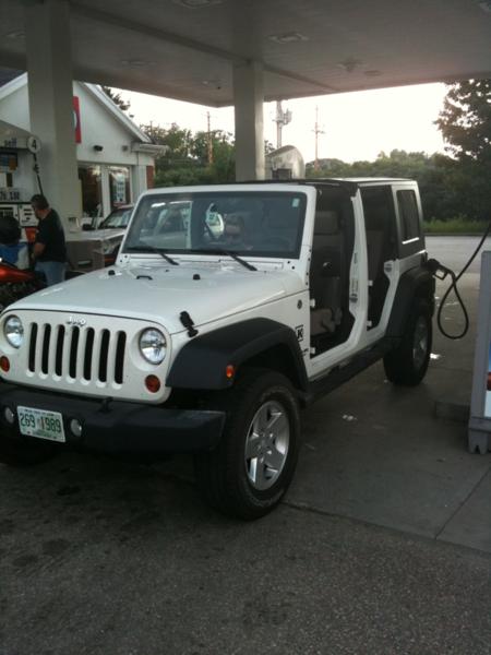

Here is mine with stock wheels/tires with 1.5 spider trax spacers... Pushes your tires out flush with your fenders... Big improvement over factory look.
