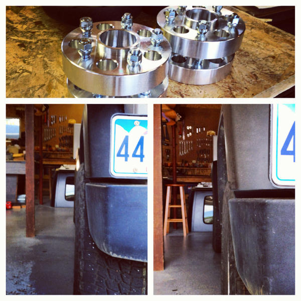

If u are on a budget look at the rough country spacers. There are alot of people that say that rough country is garbage but i have had good luck with the spacers and u cant beat the price $59 a pair. I run 37s and wheel my jeep harder then anyone in my group and no problems at all.

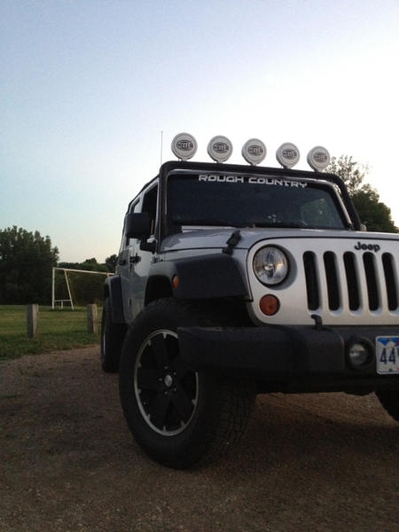

I've got rough country 1.5 inch spacers, no problems at all. I just wish they came with loctite so i didn't have to go buy some. They are hubcentric, which I believe is very important. Spidertrax is also hubcentric.
