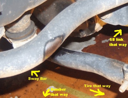

Yep... rubbing on the swaybar.
1.5" spacers fix that and bump your stance out 3".
