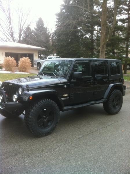

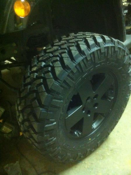

Just put them on our JKU. Bed lined the wheels black.

The blacked out stock rims really look good. How much is involved in bead lining them? and how well will it hold up to wear?
Old Jan 9, 2012 | 06:42 PM
brent1024's Avatar
Posts: 181
From: Northern Indiana
All in the prep!!! I used a scotch brite pad (fine-green) and scuffed them up good, then cleaned them with brake cleaner and soap and water. Once they dried I used 3 coats of self etching primer and sanded in between coats. Make sure to use some quarters in the lug holes to keep the paint/liner out the threads. Quarters fit perfect!! Then I did 4 coats of rust oleum spray bed liner on. Total about 4 hours and a 6 pack! Just take you time and wait for coats to dry and make sure they are nice and clean before you start any coats of primer and liner!! I let them set overnight in the shop and mounted then up the next day. Hit them with the pressure washer about a week later and not one flake! Got around $50 into it (not counting the quarters).

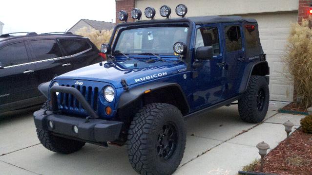

I have 35's, 1.5 wheel spacers and bushwacker flat flares. No rubbing. 2.5 bds lift kit
Todd
