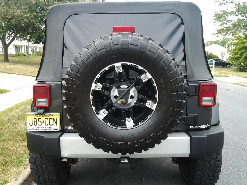

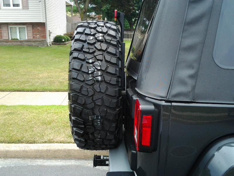

I had a Smittybuilt "oversized tire carrier" on my 2010 JKU Sahara with 37X12.50R18 BFG KM2 tires

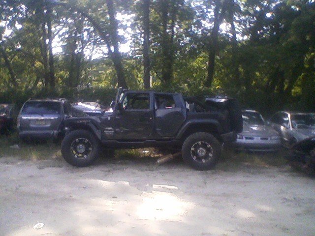

Don't know why everyone keeps saying they will damage ur tail gate cause the tailgate was the only thing left in tact after i rolled her in Aug.
Only pic u can see the tire, but trust me.... It was i think the only thing that wasn't damaged! Lol
