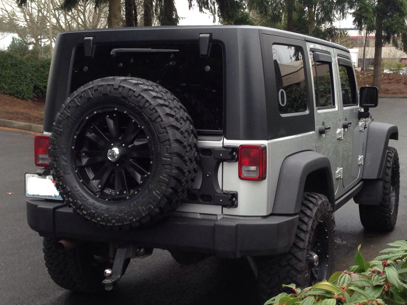

The Teraflex carrier sounds like what you're looking for. Recent thread you might search about it, and check out their site.
Old May 31, 2014 | 06:11 PM
Wrangler428's Avatar
Posts: 235
From: Auburn, WA
X2 on the Teraflex.

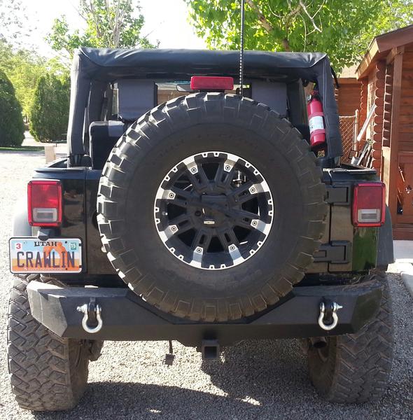

Just my experience but I have the smittybilt oversized tire carrier my jeep is an 08 and it's been on there since 09 I have 37" tires with alloy 18" Incubus rims my gate doesn't sag rattle or show any signs of any issues I have put plenty of miles on bouncy dirt roads and not had one problem I know it's a lot of weight for the gate but having no problems myself I could only recommend it to others based on my own experience
and for price I don't think you will find a cheaper option at $120 jmo Click image for larger version
and for price I don't think you will find a cheaper option at $120 jmo Attachment 556867
Got any pictures with the tire off?
