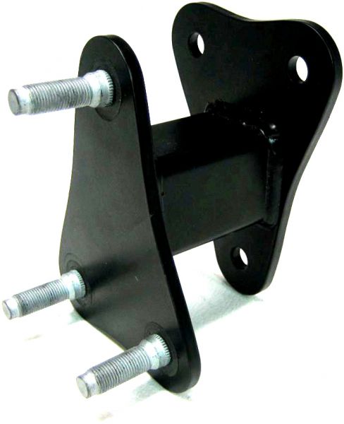

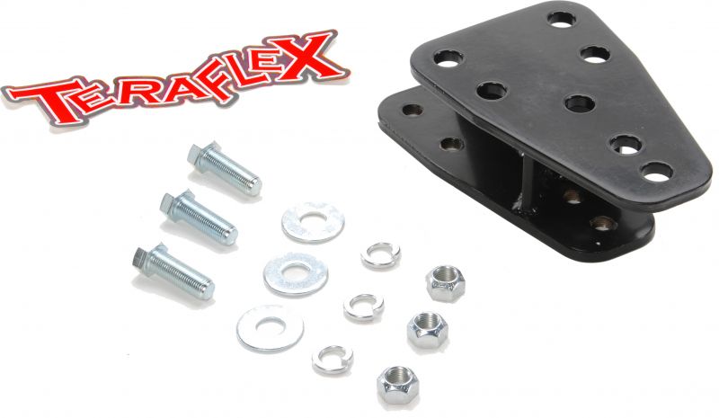

I'm looking for a spare tire spacer that helps making the 35'' tire rests on the stock bumber. This would hold the spare from vibrating. Basically, I don’t want to see my spare tire flying somewhere while driving .
MBRP: it seems good for me
Wheel spacer: is heavy
TeraFlex and Rugged Rige: they re-locate the tire up or down and blocks the third brake light.

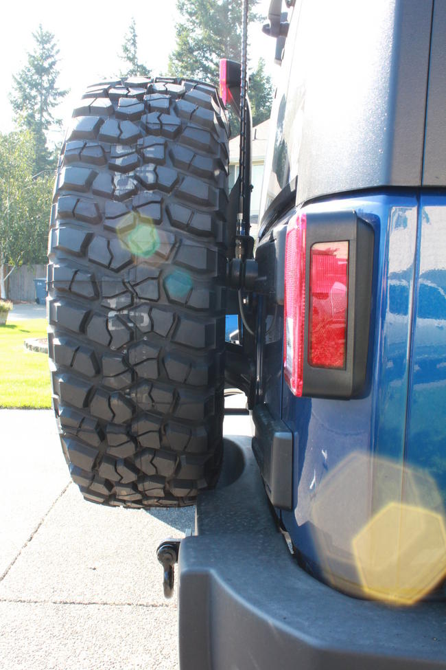

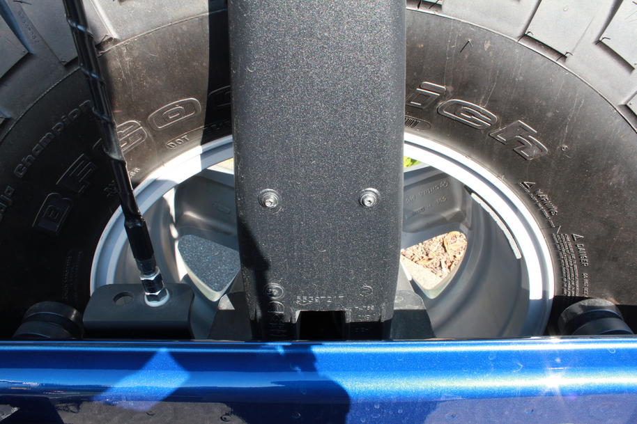

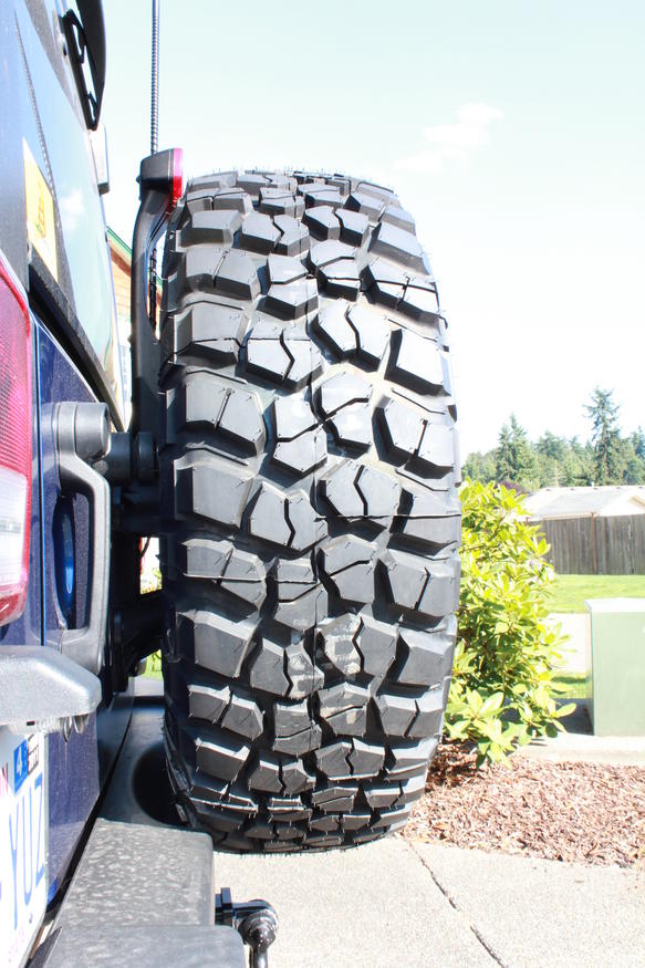

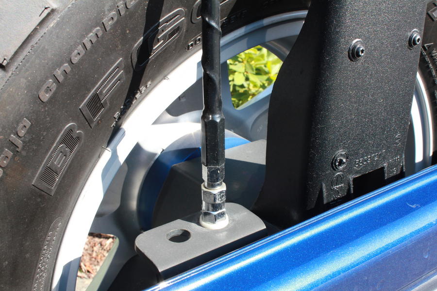

I went with a Spidertrax wheel spacer and it has served me very well so far. It gives me just enough clearance for my 35 BFG MT's mounted on my stock wheels but doesn't stick out too far to adversely increase leverage placed on my tailgate. I've been running this way for well over a year with absolutely no sings of wear on my tailgate.
I would not recommend the mount that lifts the tire up and out because that greatly increases the leverage placed on the tailgate.
Also, make sure you extend the spare tire bumpstops so that they make solid contact with your spare tire.
