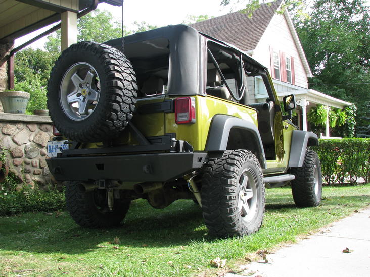

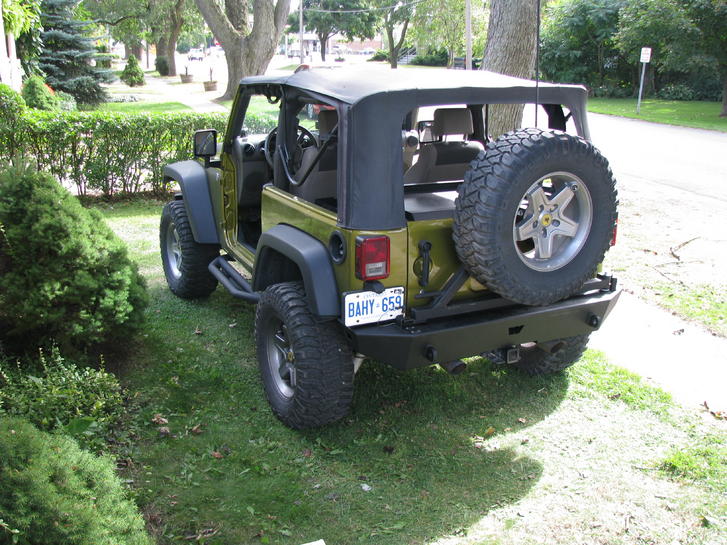

I have the rear rock crawler and like it allot. I have no problems with it at all. Have 33" on now but shortly going to 37". Solid rattle free bumper.

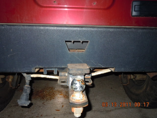

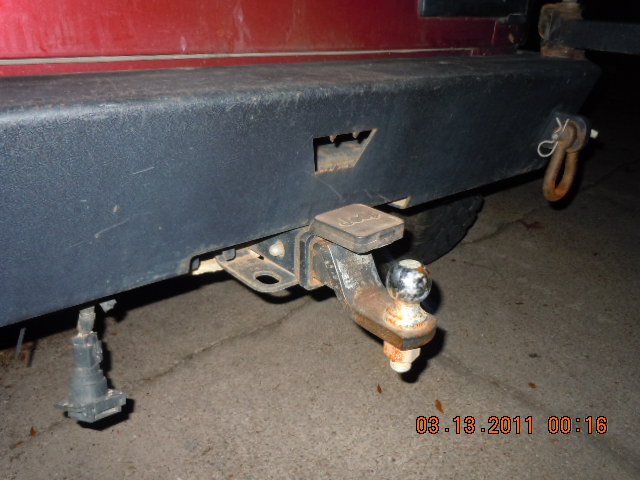

no problem with the hitch. the warn bumper has a small notch in it to fit over the hitch.
Old Mar 12, 2011 | 08:27 PM
captjay's Avatar
Posts: 632
From: pensacola, florida
the rockcrawler extends 7.5" past the tailgate and the gap between tailgate and top of bumper is 3/4"
I don't know how high the stock carrier will bring your 35" tire up, but you may have to come up with some type of extensions or risers to accommodate it. I don't think the stock carrier is going to raise the tire high enough over the bumper, but I dont have those measurements. I had an after market carrier (cheapo) untill I could afford the warn carrier and my 37 had to sit at an angle because the tire went below top of bumper.
in the pic, you should be able to see the gap and also see how the stock hitch fitsClick image for larger version
