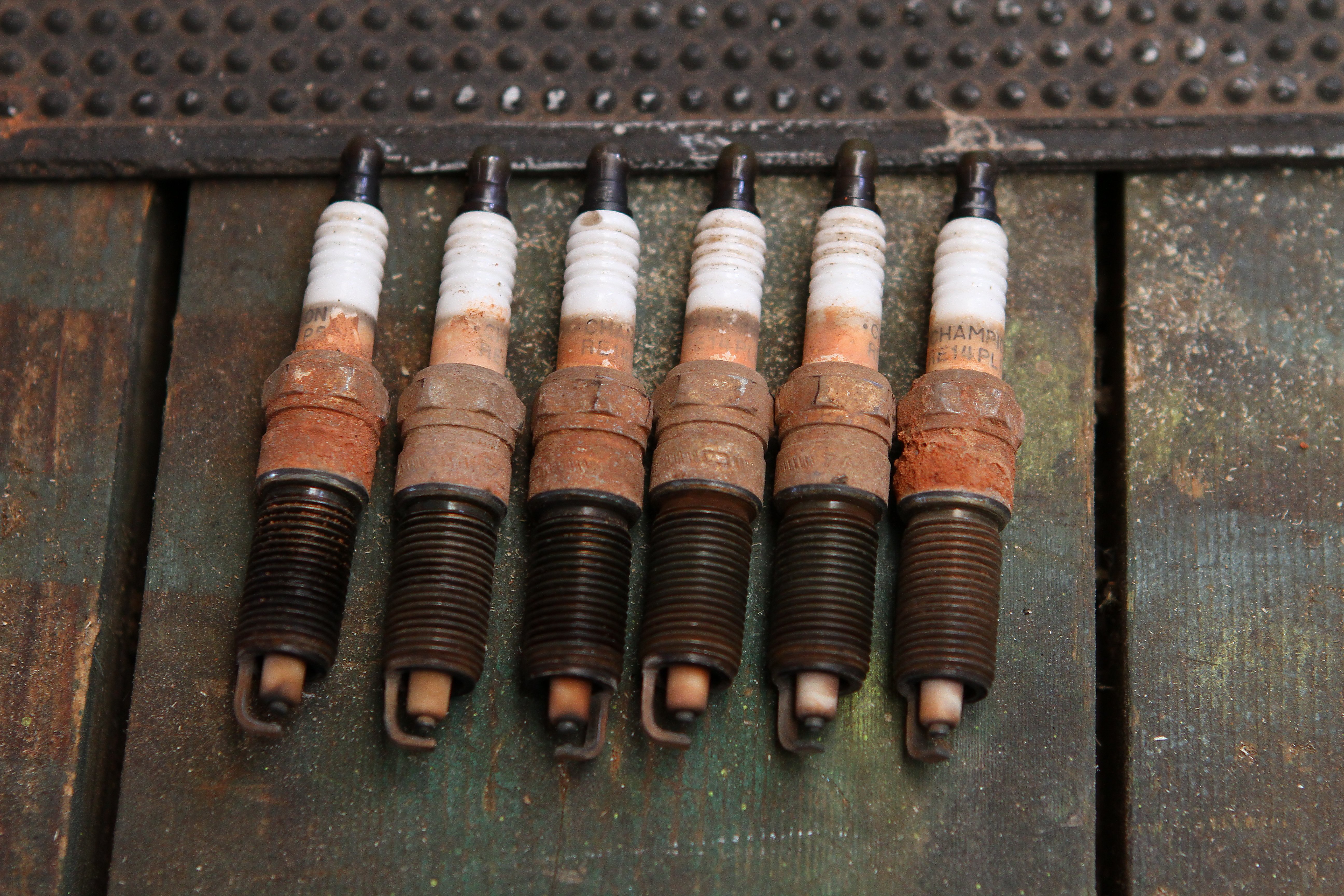

Recommend OEM plugs here. First set changed at 95K miles because I was installing a dual-battery tray and didn't want to have to pull all of that out just to change plugs. No problem pulling out plugs, no problem with misses or pinging, no problem with removing them. Here's what they looked like:

Bear in mind that the engineers who designed your Jeep and speced the spark plug gap are fully aware that it will widen. That is why they specify the gap they do. If a widening gap was a problem then we'd have to do like what we did when I was a kid: Pull the plugs out every few thousand miles and reset the gap. Don't imagine problems that aren't there: If you have pinging than more than likely you have a different problem with your Jeep or the gas you're buying (my experience and that of my friends with whom I travel all over the country with is to always buy 87 or 88 octane. Always, even at higher elevations).

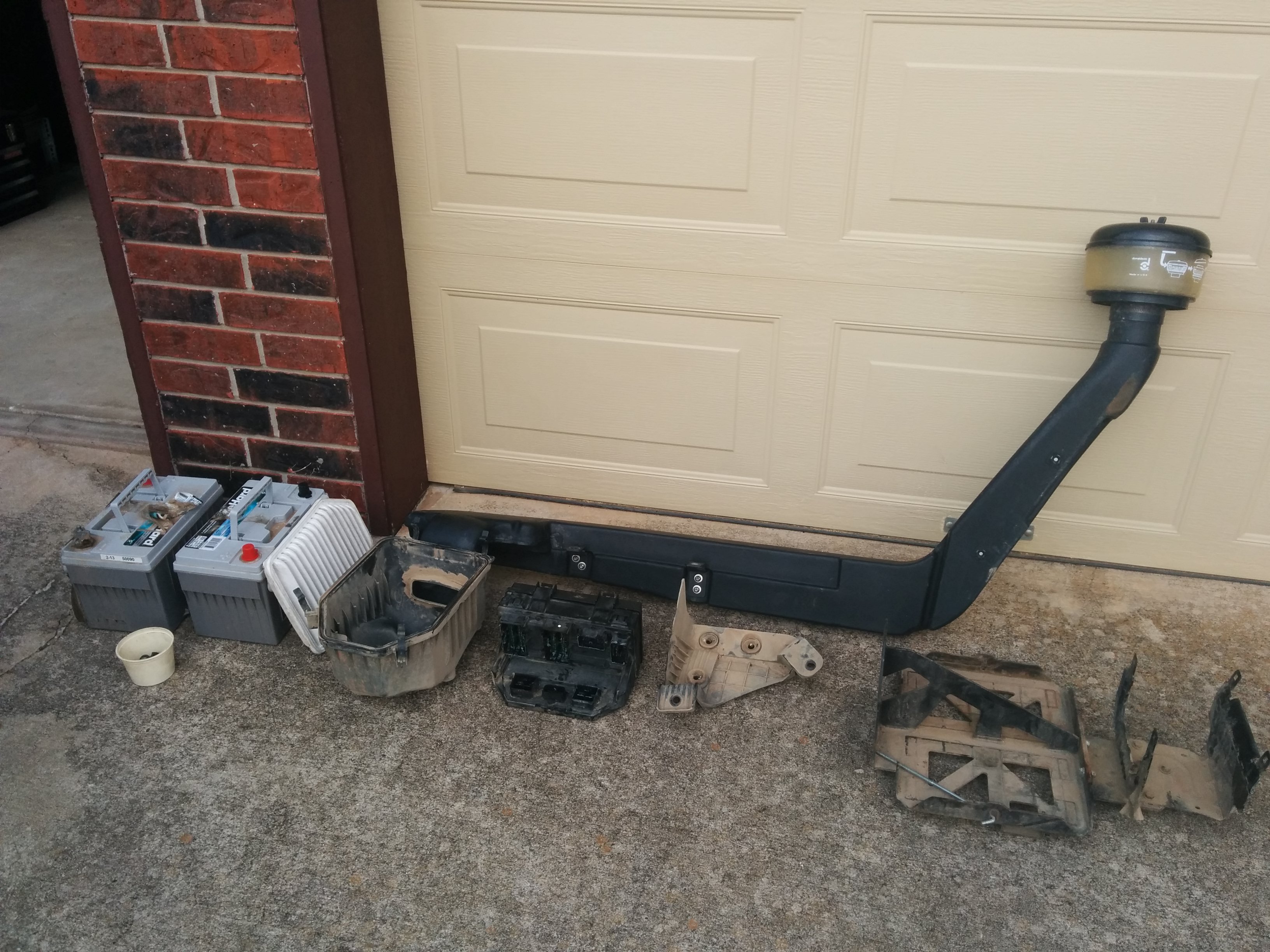

Remember that admonition I wrote above about having a different problem? Yeah, head gasket. That means this all over again ...
