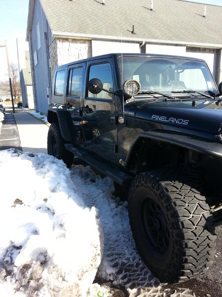

I put the 2.5 AEV kit on last summer and am running 35" Mickey Thompson's and am very happy with the setup. I did add the Geometry Correction Front Control Arm Drop Brackets after a month because I run a lot of washboard road. The improvement was worth the upgrade. No other changes were made or needed in my opinion.
The cellphone picture is from today after I created an additional parking spot at the doctor's office. You can see I run pretty level. I hope this helps. Click image for larger version
