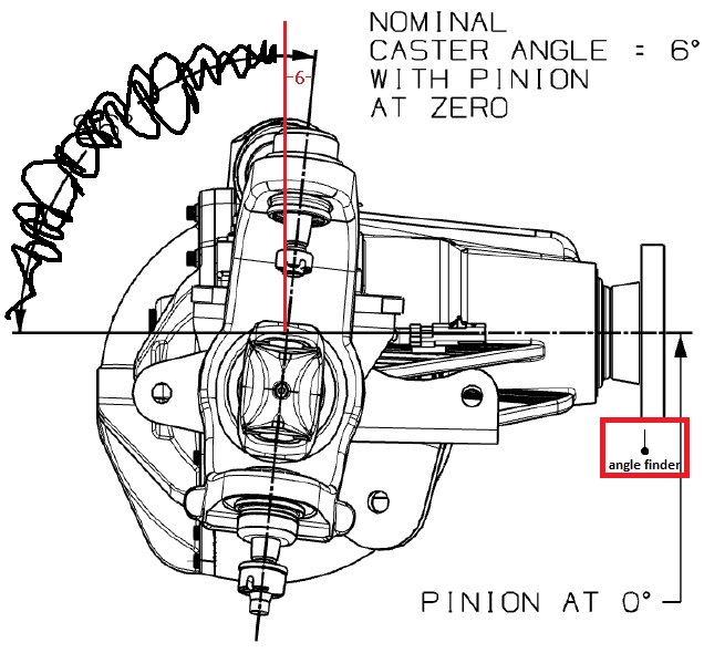

Okie dokie……You have a lifted jeep witht PR44/60 combo. You’re pretty well invested in this thing already. Honestly, take the time to understand caster…..it’s kinda a big thing, especially when it comes to handling of your jeep. I’ll revert to my favorite picture here again....but it’s with a factory axle whereas you have a PR44. On the factory axle, there is 6* of caster built in. That means with your pinion flange sitting parallel with the ground, the C’s have a 6* tilt to them. This tilt is “caster”. The more perpendicular to the ground (straight up and down) the C’s are…..the more flighty/crappy steering you’re going to notice. <perfect opportunity for Rednroll to dig up the Pabst boyz vid on caster>. You’re PR44 axle has 10* of caster built in I think (without looking)….but someone can correct me if wrong. Anyhow, same concept.
Name:	jk caster.jpg
Most of us with a 3.5” lift will run in the 4-5* range of caster. Just because you have a certain amount of caster "built in" to the axle, doesn't mean you run that.....it just means you have a greater range of adjustability to work with. From the factory the JK runs 4.2* caster as reference. When you get an alignment, just take note of the caster line that will be on the print out. Not to hound on it or anything, but take the time to really understand your set up rather than just hoping some shop will fix things right up for you. If you don’t, it’s gonna be one long and frustrating ownership. You should already see that others are willing to help you out with info, so if you don't understand just keep asking questions and STRIVE to understand rather than throw your hands up and pay someone else to just make it right. Dealers will be worthless for your suspension, and shops are going to be hit and miss. They are concerned with profits and selling you both labor and parts as a priority.
Attachment 674696
The regular PR44 has 6 degrees. The PR44 Unlimited comes with 10 degrees.
Regardless, the rest is spot on.
