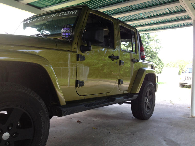

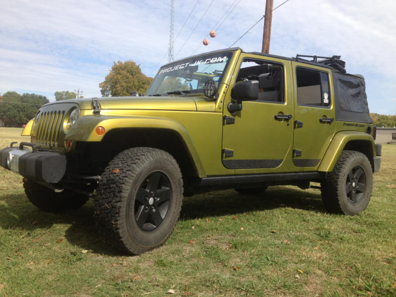

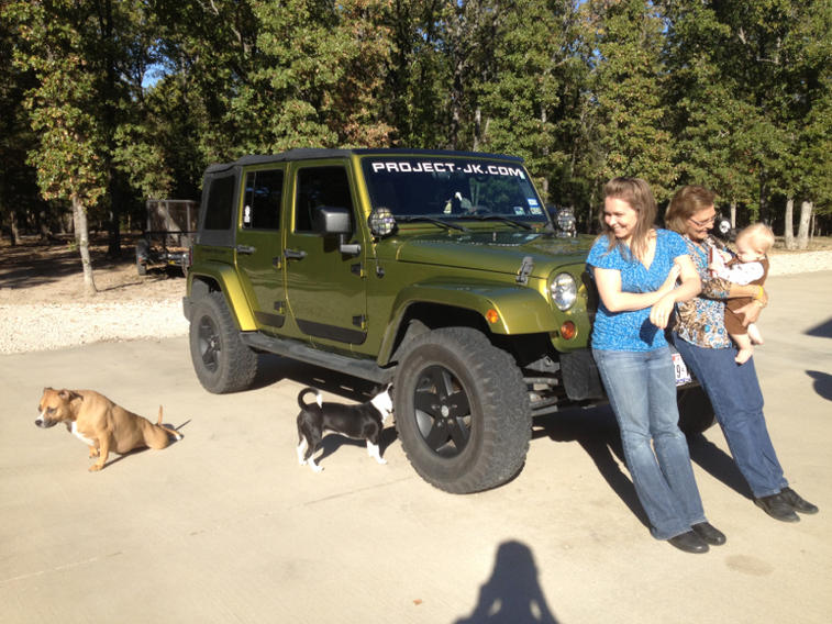

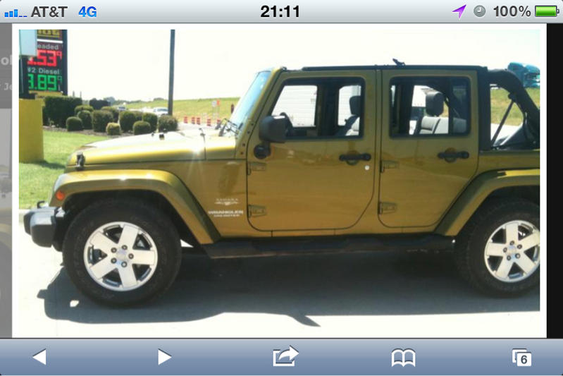

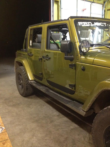

I gained a good amount on my sagging low number springs. I swapped for 18/59 springs.
I am running 285/70/17 BFG A/T KO tires on stock wheels with 1.5" RC wheel spacers.
Here's my original look when I bought from Dealer:
Here it is sitting today:
Oh... And here is a picture of it with stock tires and Rubicon suspension:
