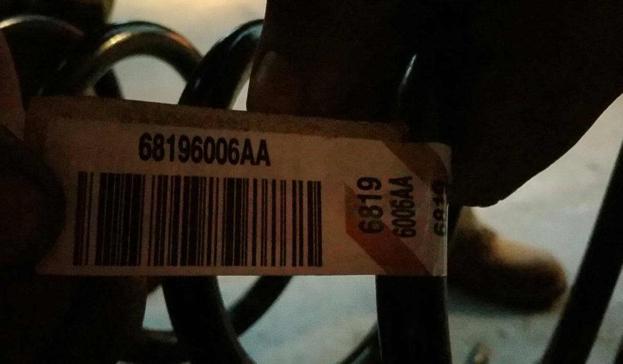

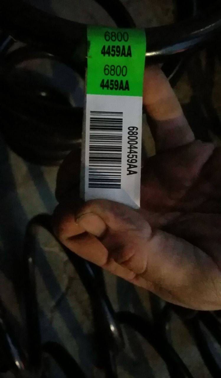

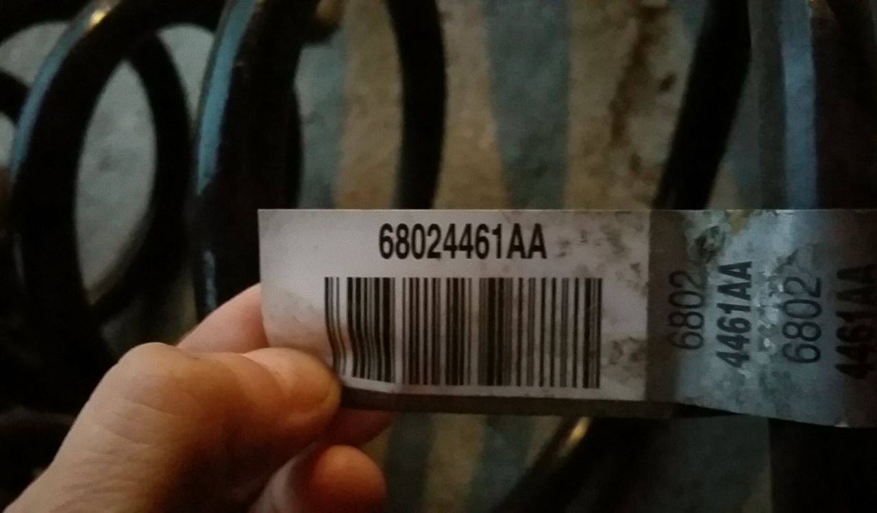

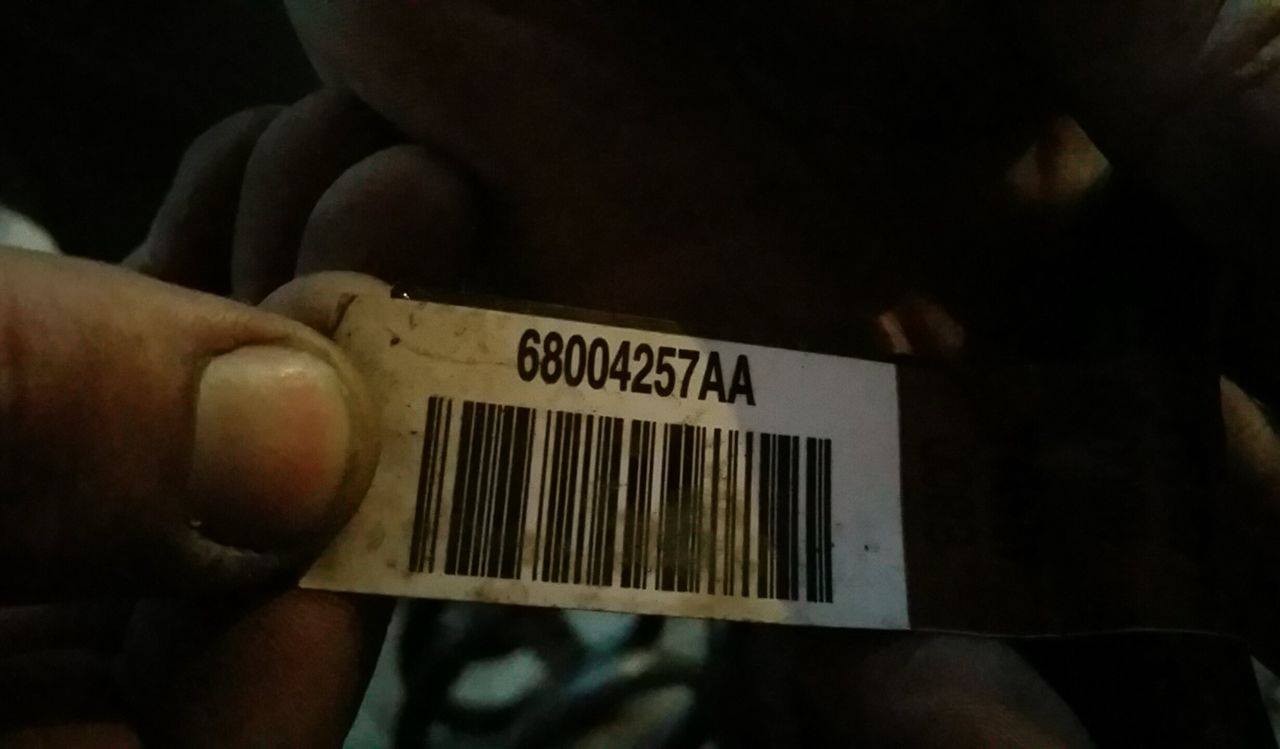

I'm so confused on what you have spring wise. Lol. Post pics of the tags on the springs. Also what spring numbers are currently on your jeep?
ID:	646434Click image for larger version
ID:	646435Click image for larger version
ID:	646436Click image for larger version
ID:	646437Click image for larger version
Not sure whats on there now. Ill go look
Old May 8, 2016 | 07:27 AM
karls10jk's Avatar
Posts: 5,642
Likes: 486
From: Knoxville
Your rubi fronts appear to be 10A coils. The rest can be found in "stock springs, let's solve this". Highest numbers win, with the exception of the 10A's- they're down in the single digit range.
Old May 8, 2016 | 08:28 AM
DunnyBunny's Avatar
Posts: 3,863
From: Bossier City, LA
I was thinking the same thing. If you have 2 of those 10A then throw them up front.

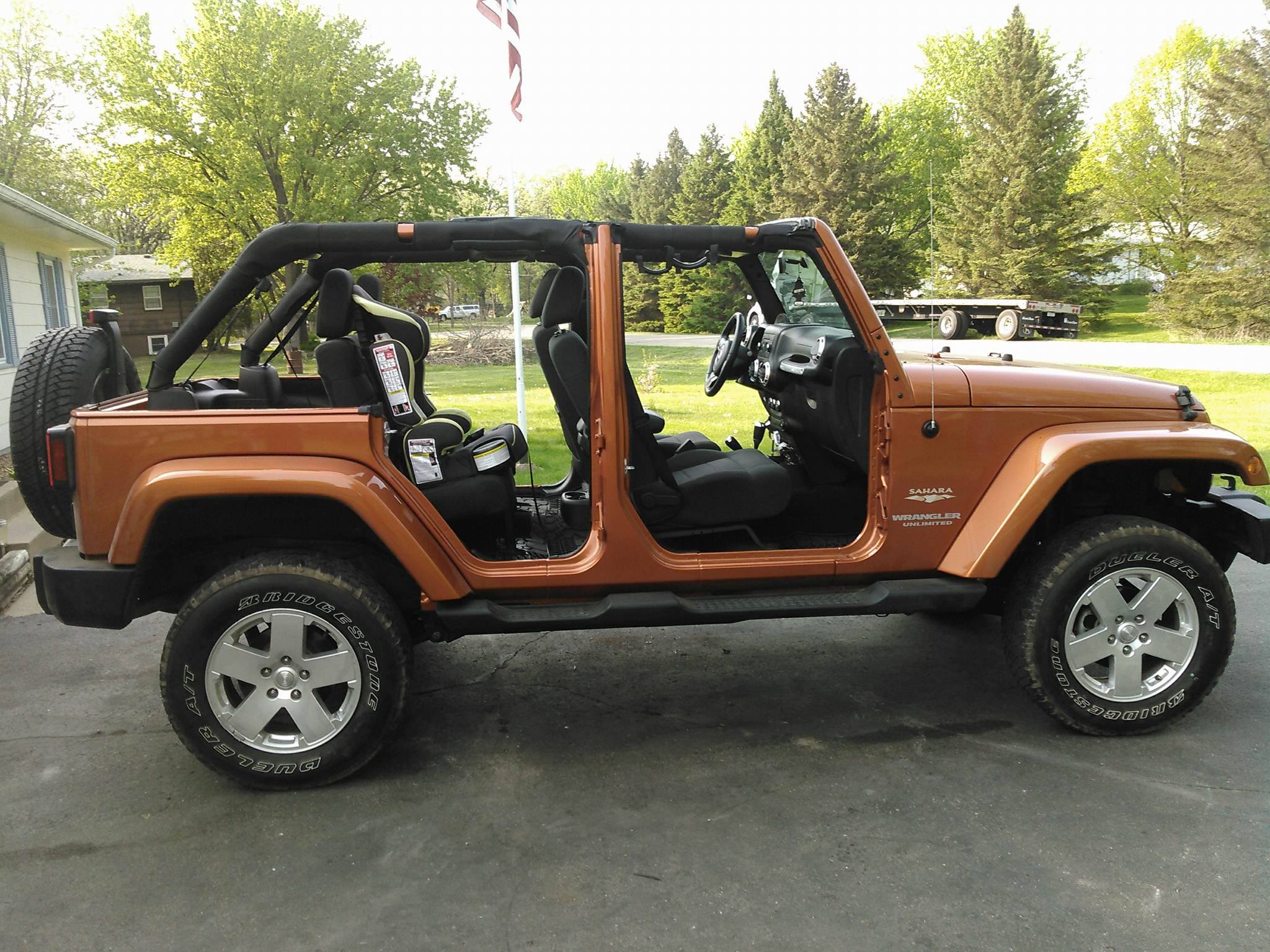

Thanks guys. Neighbor ended up coming over and come to find out he is a Jeep head. I went with the 68024461AA rear springs and the 68196006AA up front. Compared to all the other springs they were 1.5" taller unsprung. Not sure what their weighted height difference would be but compressed they are 1 coil less compressed than the springs I pulled out of it. All said and done my stock fenders are now 41" tall. 4" lift up front and 3" in the rear. All measurements were taken with roof and doors off.

From your first post, I got the impression that you wanted to do this on the cheap?
With 4 inches of lift (3.5" after top and doors go back on?), you are looking at wanting caster correction, axle centering, bumpstops, longer shocks, longer brakelines, draglink flip/drop pitman, etc, etc, etc. Basically, a full on lift kit...
Didn't think I was going to be that high.
