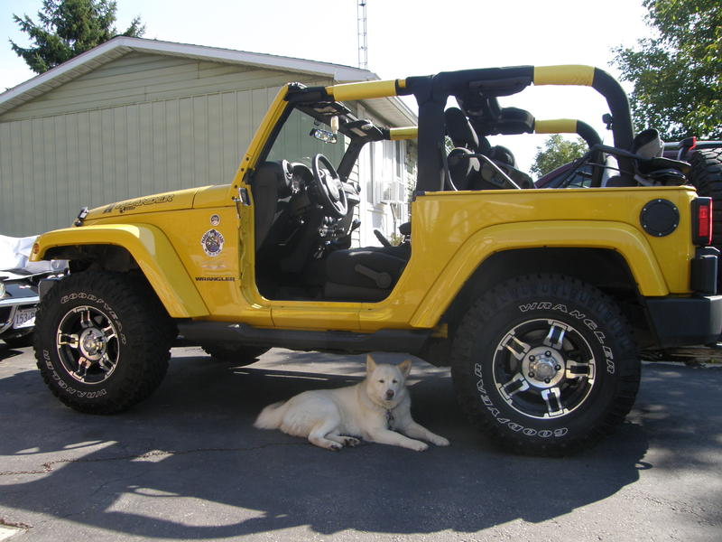

I'm afraid I can't answer the #'s question but I've done a similar swap to my 2dr, a 17/18 front compo and 58's in the back and gain about a 1" all the way around. I'm also in the process of gathering parts to install a winch on the front, (in the stock bumper) too. My Superwinch is spec'ing out at 85 lbs though.
I'd be interested in seeing how thinks sit after your install. You don't however mention if your sticking with the stock bumper or going aftermarket steel. That is adding a LOT more weight. Either way as
you have not yet purchased the shocks, I would suggest going 19's in the front to support that extra weight, (or aftermarket).
Post some pic.
