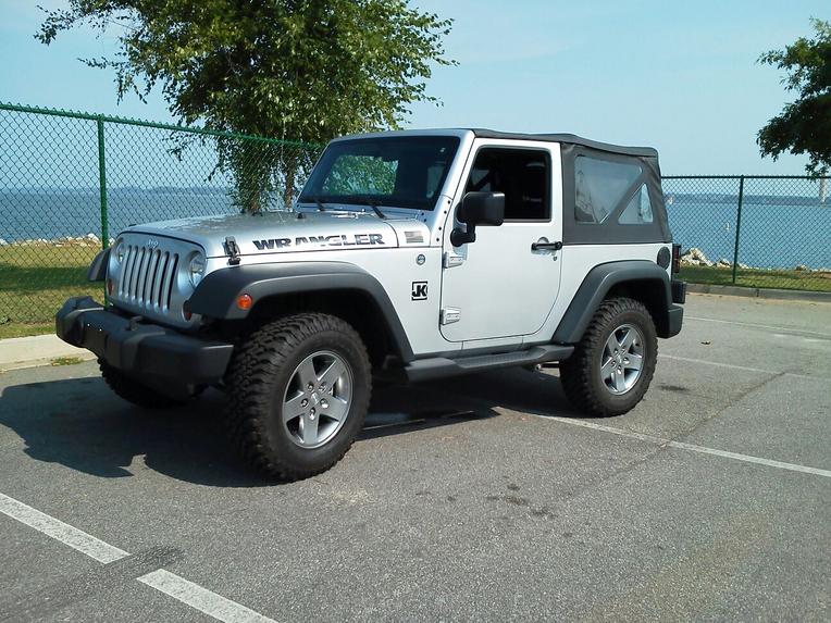

Mine is a 2 dr unlike yours. Before and after
ID:	538232Click image for larger version
