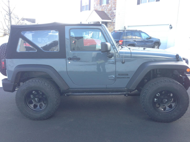

I completed the swap to stiffer spring this weekend and while swapping springs I added the 1.75 rock krawler spacers. Between the two, I ended up getting 3" of lift in front and 2.5" in the back(eliminating any rake). My original expectation were for 2.5" in the front.
I am now concerned with the 3" lift up front and what problems I may have to deal with. Does anyone have any advice on what additional changes I should look into to eliminate any problems in the future.
Adjustable track bar?
Adjustable lower or upper control arms?
AEV JK Geometry Correction Front Control Arm Drop Brackets?
I am just a bit lost as I was not expecting to gain this much lift and was trying to stay at 2.5" lift to avoid these problems. My intended use is for light to moderate trails, no rock crawling.
Thank you very much for any input and sorry for the long post. This is my first jeep and first time working on any vehicle.
