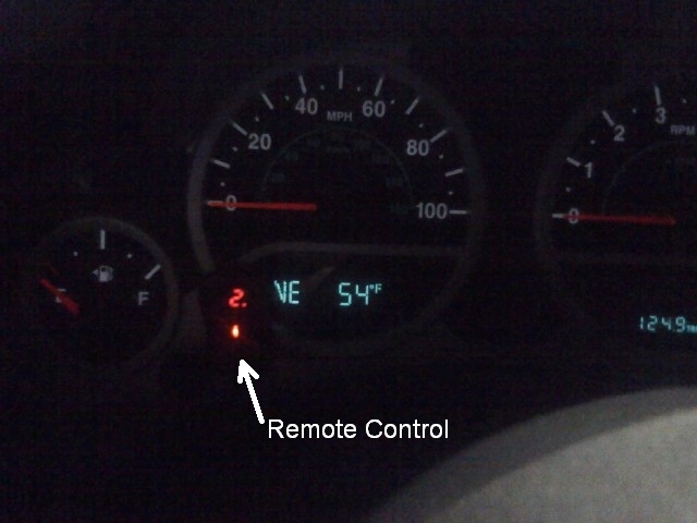

This is the new (December 2016) version 3 of a device that plugs in between the throttle pedal and the PCM (Powertrain Control Module), and modifies both of the pedal position signals to the PCM in an effort to improve and customize throttle control for the driver.
There are 37 possible settings, 18 each for automatic and manual transmissions, plus stock unmodified. There's a one-button toggle between Stock, Green, and Red settings -- Green and Red each having 9 possible saved settings. The user interface is a small remote unit that plugs into the main unit, and can be removed after setup if desired.
The selected program number ("2" in the above pic) can be turned off by holding down the center button for a few seconds. In this case there are just the two previously saved Red and Green available, plus stock.
