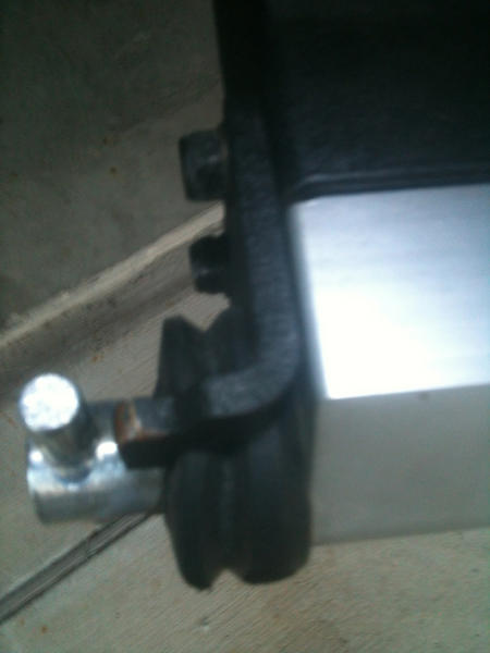

Do you have the additional part "L" bracket makes the latch tighter? I got mine from Smittybuilt and it fixed it. It doesn't move at all now.

I don't have that piece. Did that come with the original package or did they send it out later?

I had to call their customer service; they shipped it for free and at no cost to me.
