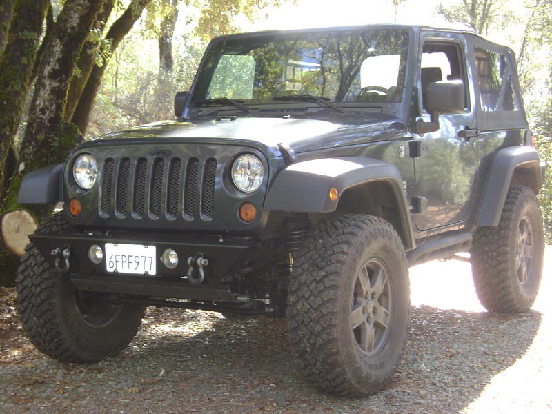

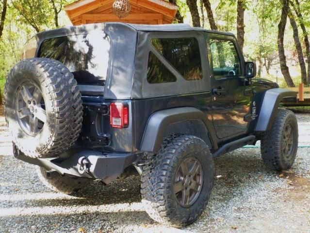

I started out with a 2.5" susp lift. Added 3/4" spacers to front, 1" in back. Going just over 3" I needed adj trackbar, longer front lca's, slightly shorter lca's in back to correct pinion angles, also brake line extensions, and adj swaybar links to keep the swaybar's handling good. Going over 2.5" will require more parts and fine tuning.

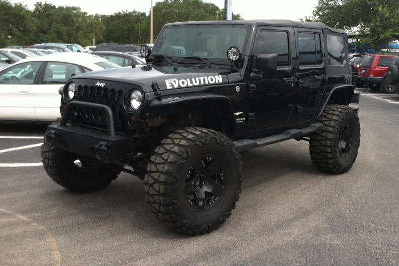

My buddy's got a 3.5" teraflex suspension with a 2"BB on top, and then a 1" body lift on top of that. Doesn't look too bad haha
