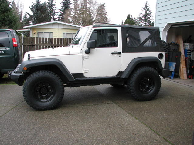

DEZ JK's Avatar
Posts: 47
From: puyallup wa
I just installed the EVO 1.5in leveling kit in my 2010 jk ,the kit comes with front springs that are designed to handle the weight of bumpers and winches while leveling out the Jeep and for the rear it use a 3/4in spacer, this kit is easy to install and the ride is better than stock In my opinion, I also installed 35in tires and to finish I will trim my stock fenders.Click image for larger version
