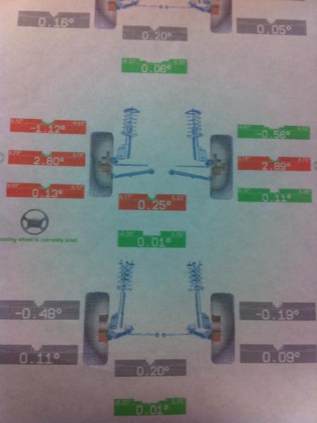

The second one is before they tried to align it and the first one is after they messed with it. They said that they couldnt fix it.

Looks like your driver side camber is outta spec, you need an adj ball joint on that side.
BUT I suggest that you fix the balljoint /and have them inspect the unit bearing on that side. Most likely the bj is blown,C-bent,unit bearing going bad and or bent axle housing.
Your castor is basically 2.8-3.0 degrees, you can fix that with adj ca's and or the dreaded cambolts if you want, but you should REALLY get your camber fixed before you address that. The camber being that far off is most likely the catalyst for your wobble.
Your toe should be somewhere between .10 to .20, easily fixed .
I suggest to bring it somewhere wher they know what the hell it takes to fix your issues, they apparently do not.
Is it a bad thing for me to drive it like that?
Your tires are gonna get chewed up if you don't fix your camber/toe. You'll end up eating up 10,000m of life outta your tires in front in a couple thousand, fix as soon as possible.
