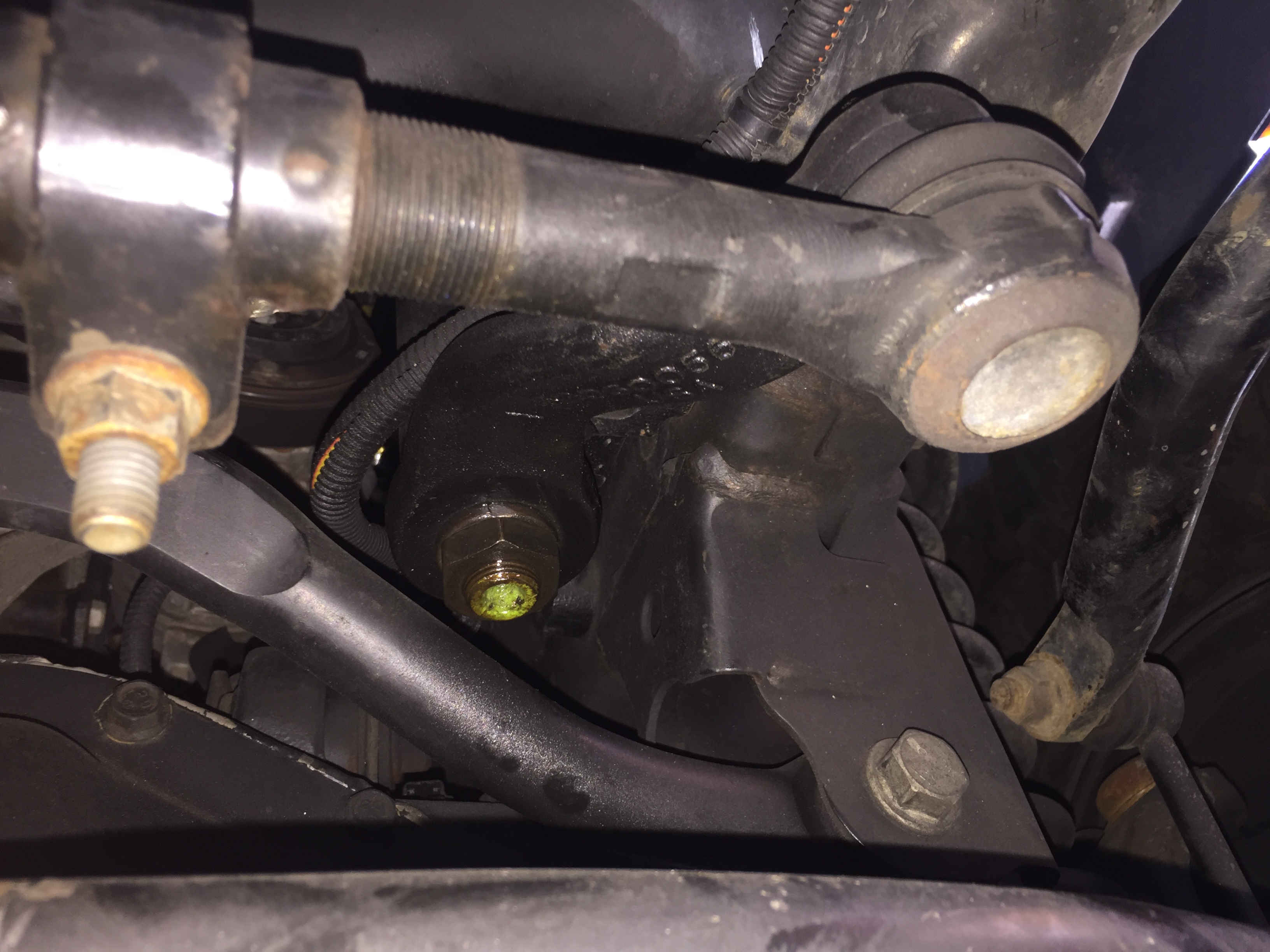

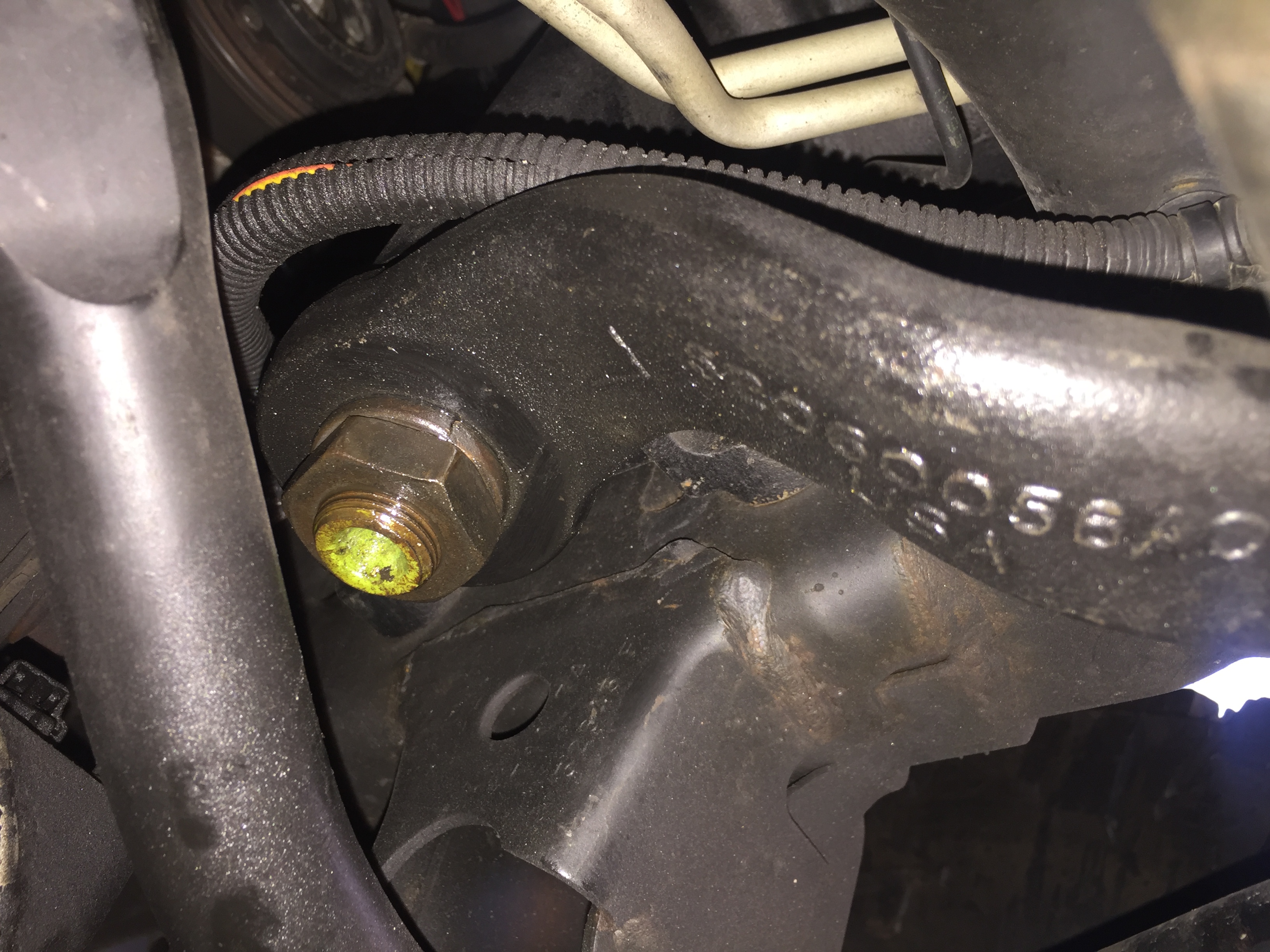

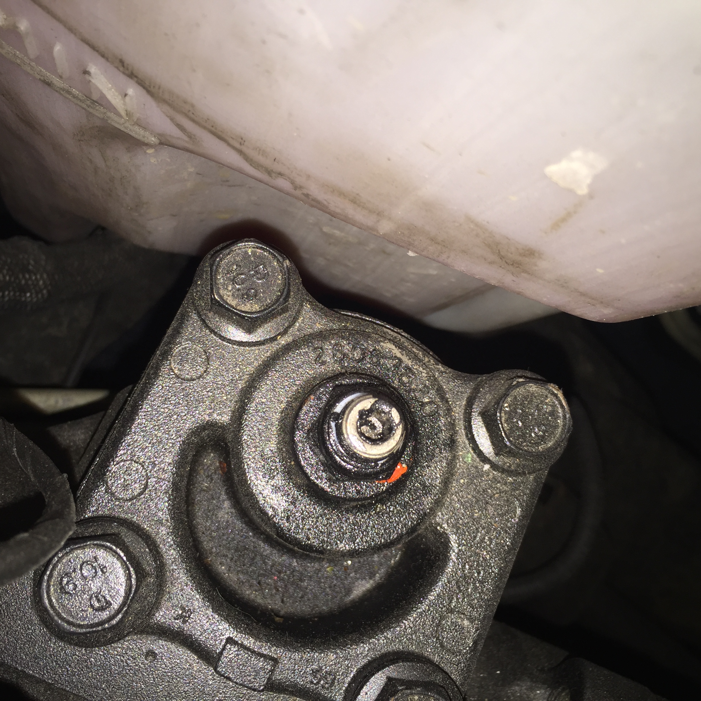

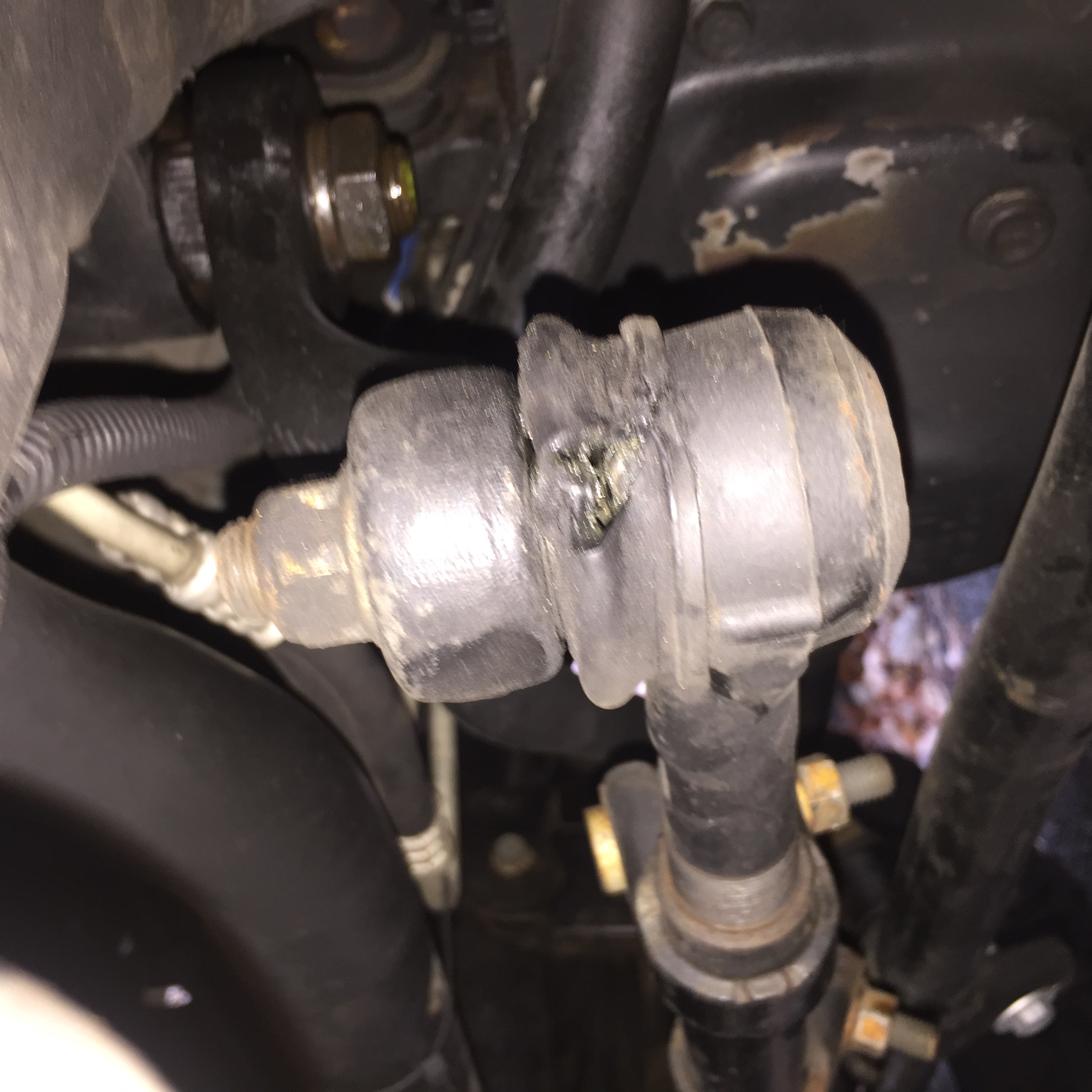

What's up everyone!
today I decided to check under my jk & saw my pitarm soaked in some fluid/oil, and checked the top of my steering box and it has some oil, so I'm not sure what's going on there, now I don't want to take it in to jeep to have it "DIAGNOSED" because they'll charge me $150.00 if they find nothing, this is where the forums come into play ....
Also the draglink bushing seems to be blown 🙄..
Let me know.
Appreciate it

Originally Posted by dark_jku
What's up everyone! today I decided to check under my jk & saw my pitarm soaked in some fluid/oil, and checked the top of my steering box and it has some oil, so I'm not sure what's going on there, now I don't want to take it in to jeep to have it "DIAGNOSED" because they'll charge me $150.00 if they find nothing, this is where the forums come into play .... Also the draglink bushing seems to be blown dde44.. Let me know. Appreciate it
Sounds and looks like the seals have failed in your steering box. Mine failed in my 07 about a year after I bought the jeep new, but I also beat on it. I would say have someone rebuild it or upgrade to a redneck ram if you want steering assist. They rebuild boxes as well (part of the stage 1&2 packages). A new box is pricey, unless you can find a donor or someone who went hydro. Hope this helps

Also check and see if your draglink end is hitting your Swaybar. That drag link boot looks damaged right where it might hit. I had an issue with this but I've done a bunch of mods, or have a slightly twisted sector shaft, that may have caused it. It does look like there are signs of contact with something on your Swaybar where I drew the arrow.
I ended up grinding some clearance into my Swaybar to fix my contact in this same place...

Also check and see if your draglink end is hitting your Swaybar. That drag link boot looks damaged right where it might hit. I had an issue with this but I've done a bunch of mods, or have a slightly twisted sector shaft, that may have caused it. It does look like there are signs of contact with something on your Swaybar where I drew the arrow. I ended up grinding some clearance into my Swaybar to fix my contact in this same place...
I did not see that last night. It does look as if it is making contact. Good eye
