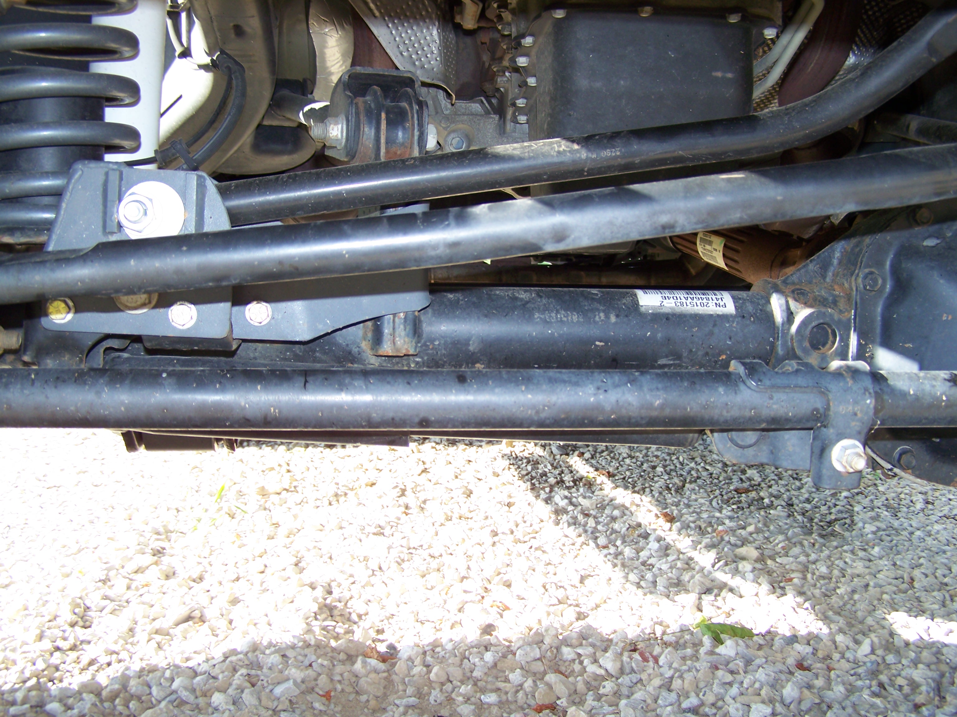

here are the picks of the front end. The TB and DL seem to me very parallel to one another.

while the links looks parallel, they are on very different planes and follow different arcs. You can do a drop pitman and drop TB bracket (not ideal) or raised TB and flipped DL. What you have is a mix-and-match set up. Pull the drop pitman arm, flip the drag link with an adapter, and leave the TB alone.

So my TB needs to be raised even more than what it is now with the current raised bracket that came with the lift? Will the Synergy setup do that? I guess I am having a hard time understanding this.^^ From the info you guys have given. I need to reinstall the stock pitman arm, raise TB and flip the DL to the top. I am ready to pull the trigger. I just want to know for sure the direction to point.

No from the looks of your setup, reinstall the stock pitman arm and get the Synergy draglink with the $10 adapter. Your TB is already raised so leave it alone. What you currently have is a mismatch. You have a drop pitman arm with a raised TB. Not what you want.
Getting only the Synergy draglink and the $10 adapter will allow you to flip the draglink to the top of the knuckle and give you the flipped draglink and raised TB that is ideal.
However, this is what I would try first as already mentioned, put the stock pitman arm back on and take off the raised TB bracket and drive it like that and see how you like it first. You may like it fine and it give you no issues.
With the draglink flipped you will need to limit your uptravel with at least 3" of bumpstop to keep the draglink from hitting the frame or notch the frame. You will also need the correct drill bit size to drill out the knuckle also for the adapter. There are videos on how to do and instructions on synergy website.

Yup. Chances are, however, he already has at least 3" of bumpstop with that 3.5" lift so he wouldn't be losing any travel with the flip.
Also removing the TB bracket would necessitate an adjustable trackbar. So draglink flip or adjustable TB will put you in the same price range. One may benefit you more than the other at your height.

Yes if you look in the pic I do have a big a$$ bump stop already. Ok guys finally and hopefully last Question on this.... I see that 4WD has the terraflex version for $208 vs Synergy $235 are there any differences in the two? Would you go with one over the other? Also Why cant I use my existing DL with the adapter?
