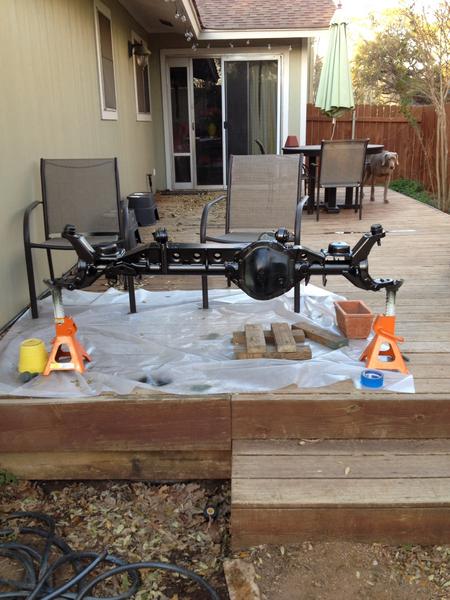

I just finished up my front axle "semi" build which consisted of Artec truss, artect c gussets, inner axle seals, jks adj. bump stops, synergy hd ball joints, arb diff cover and fox ATS stabilizer. I also added some spidertrax spacers during the re-assembly.
The issue: now currently driving at any speed the steering never wants to return to center. I don't think I have a bump steer issue, this seems more like a wonder or pull but it happens to the left and the right. In other words, oversteer, if I turn left the vehicle wants to continue going left until the steering wheel is over corrected back to the right and if I turn right the vehicle continues to pull to the right until the steering wheel is over corrected back to the left.

You may have less than adequate caster after the lift. That, coupled with new ball joints that may not want to spin easily, will fight the self-centering force after making a turn.

Pardon my ignorance, but exactly how does RK specify to set caster? I ask because some kits just have a length measurement for the control arms just to get you started, but you're expected to set the angle properly after the install is finished. Also, any control arms/trackbars that you loosened during the job were not torqued down until after the Jeep was back on the ground with all four wheels, right?

Wow, that drag link is sure at a steep angle ...
I think you might be on to it... Doesn't the Artec truss kit raise the track bar mount location? If so you will need to flip the drag link.

Nevermind.... I looked at your pictures again and noticed you didn't raise the track bar mount. While it's less than ideal, it should be okay....
