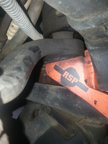

So my Synergy ball joints were stiff and now that they are broke in, my steering feels a little squishy. I had the wife rock the steering wheel back and forth an inch or two and nothing seems to flex, but I can't tell if my pitman arm is flexing. I have a Synergy TR and steering link and those feel solid. I think I'm going to have to pull my brace off to check, but does this look like too much distance between my pitman arm?

Wouldn't hurt to check the torque on the nut think it's like 185 ft lbs

Yeah I just looked at mine and there's not that much gap, like 1/4" or so.
No splines above pitman arm showing on shaft. IDK if the boxes are the same on a 09 and
My 13 ? Though.

Thanks. I'm not going to drive it until I find out. If it is loose, then I'm just wearing away at the teeth and I need to find out for sure it's torqued down.

Mine has only about a 1/4" gap as well.
