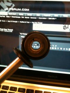

Had some death wobble the other day. Checked and re torqued everything but missed this until I was looking under the jeep earlier today. Now can o just bend the bushing back into shape or what? Thought I'd get some opinions before I go and break something else.

guess i forgot to add its an almost new teraflex steering stabilizer i bought from northridge when i put my lift on.

i have checked the torque on everything and i cant find any ovaled out holes. i was really just trying to get some ideas on how to bend back the metal bushing. i have a vice or should i just pop it out and try to find a replacement?? by the way i live on the south side of louisville near fort knox.

ok, had me scared for a minute. that is the extent of their movment. and as far as the steering stabilizer, i just put the bushing in my vise and carefully bent it back into shape. looked round again so i put it back on.
