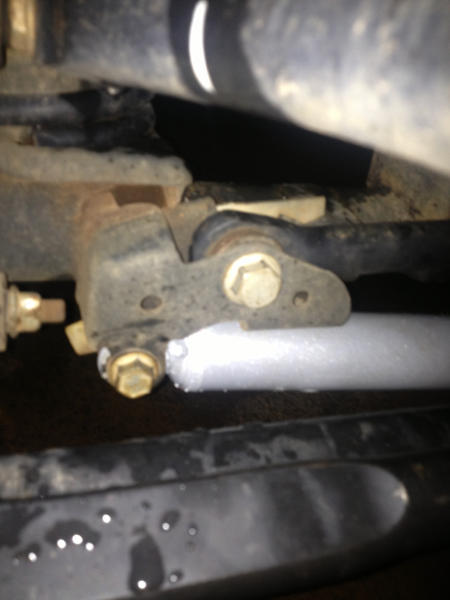

I just installed a rancho steering stabilizer and it is metal to metal contact with the stock mounting location. Does anyone know if I should relocate it or not.

I will grab a photo of mine in a few. Where is yours rubbing. Could you take a picture. I flipped my mount because mine was rubbing

It's rubbing on this bracket

Try to turn the bracket on the tie rod. It's kind of like trial and error. I put mine on jack stands and then turned the wheel each way to make sure it cleared.

Would that work or should I use the bracket rancho suggests

All the photos I see online look like the bracket would be the best fit. No metal to metal like in your photo.

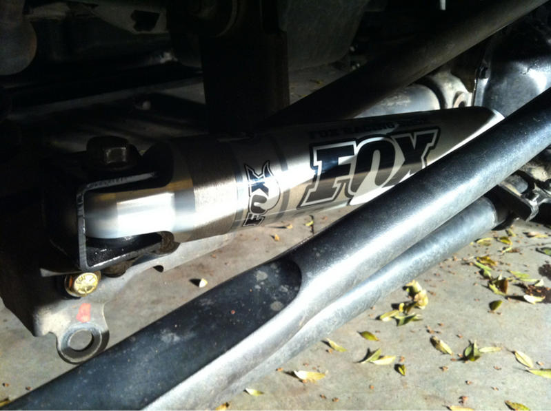

I got this relo bracket for like $25 bucks...

You could also reverse your SS. I'm pretty sure it works the same either direction.

Turn it around
