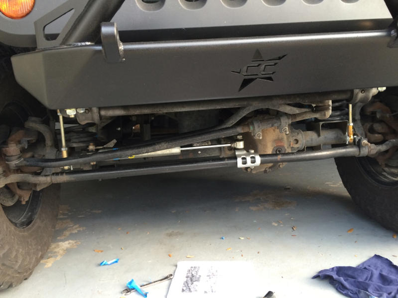

Well for $58 shipped, I think this will work out. The bracket also seems sturdy, but time will tell. I will also be taking off the sway bar links and doing a full bump on both sides, to ensure there is no binding, or hitting the top of it on the frame. The only thing I see as a small con to this, is that at full lock to the left, it barely makes contact with the drag link. I don't see that being an issue, but again, we shall see.

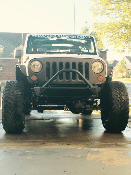

Running the rancho and it does its job. 0 complaints
ID:	602933   Click image for larger version

Post Sure looks like a Bilstein shock to me...
The yellow and blue label gives it away
