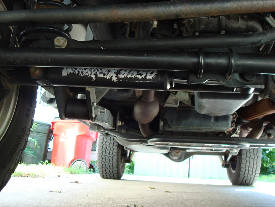

I had a BDS SS and had the same problem. Just installed a TeraFlex and it works really well so far, it actually mounts opposite of the other stabilizer.

OK I would install that so the body end is on the other end. That will give you more clearance.
