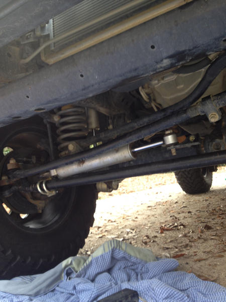

Here's the best I could come up with. Thoughts? And when I mount the left end I should mount it at half drawn correct?

3/4? Most are 1/2
Looks ok though. I would turn your wheel all the way to the drivers side and position (verify) the shock is about 1/4 in from fully compressed. That should give you enough travel in the other direction.

3/4? Most are 1/2 Looks ok though. I would turn your wheel all the way to the drivers side and position (verify) the shock is about 1/4 in from fully compressed. That should give you enough travel in the other direction.
Yep it's 3/4. Full steer is fine on both sides, only thing is the drag link barely comes in contact with the stabilizer body when it's pivoted downward but I don't think it's enough to cause any damage at all.

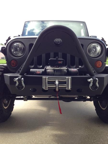

I had mine set up the way you are running in the second picture and had no issues. I recently added the second shock and a second mount to make it a dual unit so it looked more balanced. I couldn't tell the difference from the single to the dual set up but it looks more balanced. I wasn't able to use the synergy tie rod bracket on both sides so I only have it on one of the sides as the tie rod bends right where I mounted the second mount. Its staying this way until I get bored.
