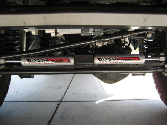

Old May 2, 2010 | 06:40 PM
*Seth*'s Avatar
Joined: Mar 2010
Posts: 192
From: San Marcos, CA
I have the Rancho dual steering stabilizer and I love it. When I hit pot holes or bumps, there is no excessive jostling or play. The steering is tight and responsive.

Old May 2, 2010 | 06:59 PM
Hellbound13's Avatar
Joined: Apr 2008
Posts: 4,470
From: Westchester, NY
Thats the Rough Country dual.
Old May 2, 2010 | 07:43 PM
*Seth*'s Avatar
Joined: Mar 2010
Posts: 192
You are right, that is what I meant. I got confused.
