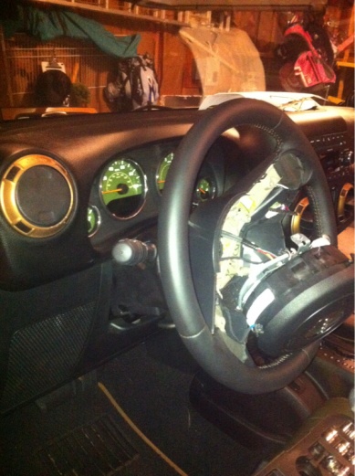

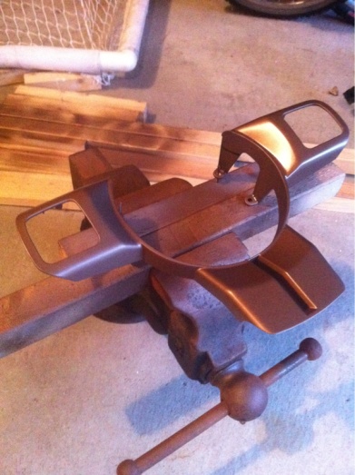

I found this, Not my words.
"There is one bolt on each side of the steering wheel. Those two bolts remove the entire airbag system. Then there are three screws that hold each section of the steering wheel togther. Those are located on the back of the steering wheel. Once the Airbag system is out you will sell 5 more screws, take those out and the entire steering wheel trim with controls will come out."
They included these pics
ID:	249279Click image for larger version
Name:	Steering Wheel Trim.jpg
While they make this sound easy, anytime I read "remove air bag" my sphincter tightens up. Those are clock spring wires hanging out of there too, very delicate I've been told.
Good luck!
