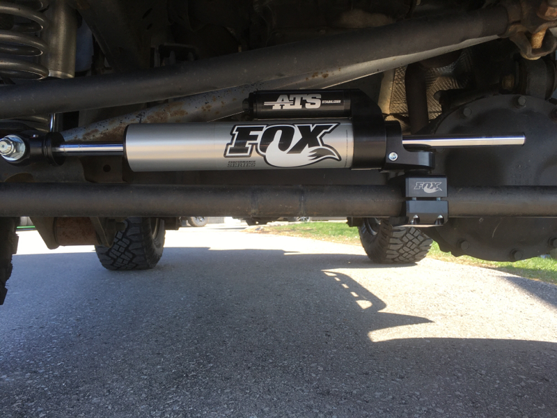

I had the exact same thing happen to me as well...4 inch lift on 35's on the highway it would wobble slightly...it wasn't that noticeable but I could feel it in my hand through the steering wheel, I did an alignment, made sure that the tires were at all the same in pressure but it would do it again...then I rotated the tires to which it helped a little but still the feeling was there so I pulled the trigger on one of these babies...and the wobble was gone, there is 24 clicks of adjustment I set it at 20 problem solved!

Problem hidden actually. If all alignment and everything else is good and set the way it should be then you don't even need a steering stabilizer. It's good to have though and I have heard the fox ATS ones are nice.
