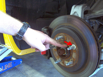

Originally Posted by JKBud
Attachment 578972
Nothing beats a picture, not a jeep but same idea.
Oh, nice. Thank you!

Image Courtesy of 4x4xplor.com
Reference: https://www.jk-forum.com/forums/modi...3/#post3991154

Amazing. Just removed mine a little while ago and my shimmy appears to be gone. I can't thank you guys enough.

Word.. Don't be fooled there still could an underlying issues of a worn drag link, tie rod, track bar etc.. having the shimmy for the first time only means there could be more in the future if left unchecked..
I'm sure if you search the forum hard enough you can find more posts dealing with this and the Death wobble. We've been systemically going through a checklist of possible causes.. balancing, alignment check removal of the clips are all stage 1 issues or things one can do to start the isolation of the cause. Our 2008 jeep wrangler and 70K miles would suggest a few upgrades are needed..
Note: Even Though I suggested the alignment check.. You need to get with a shop that knows the shimmy and death wobble first hand.. cause after three shops check our alignment, they didn't find anything wrong.. So ask them to inspect the drag link ends, tie rod ends, track bar and even the ball joints.. One may need to upgrade, which we are slowly working on ourselves.
