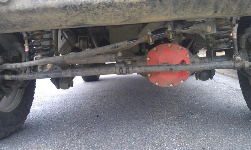

Guessing your steering geometry is correct but hard to say for sure. Is your drag link and track bar at the same angle? If so, go get an alignment and see if that fixes the issue it could be that your toe is not set right. Possible that you also have a shock or even two going bad or even a tire that is causing it, have the shop check those for you if your not sure.
If your drag link and track bar are not at the same angle post pics so we can help point you in the right direction. We will need to see your drag link and track bar in the pics.

Old Feb 29, 2012 | 03:54 AM
sneck's Avatar
Posts: 1,012
From: Boston, MA
So I don't know how that looks, but thats my front end
Old Feb 29, 2012 | 04:59 AM
Bonedoc's Avatar
Posts: 1,053
From: East Stroudsburg, PA
The fact that you don't have adjustable uppers shouldn't matter as long as your lowers are adjustable. The issue that I found is that the average shop has no idea that the caster should increase with the lift so they set it to the factory spec. Before I had mine set correctly I'd get a steering wheel wobble with front end impact on bumps, after I had it set, and the caster was the only part that had to be set besides centering the axle, it was perfect. Hit bumps all the time, and Northeast Pa roads are full of them, with no shake or shimmy.
