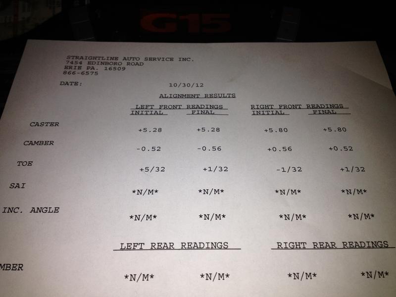

Jeep is a 2012 JKU with RK 2.5 Flex, Evo gussets, Nitro sleeves.
Ever since my offroading trip to Southington Offroad, I've been experiencing some very flighty steering. The Jeep has a tendency to pull to the right, so I keep the steering wheel slightly to the left during highway travels (65mph +) Occasionally the Jeep will decide it's not going to pull right anymore, and pull hard left. This makes it very difficult to keep on the road, constantly correcting the Jeep's pulls. I've taken it for two alignments and the last one helped a little, but the issue is still there. I've quadruple checked everything in the front end for tightness, and everything is good. The only thing I haven't done is get a grade 8 bolt kit to replace the factory metric undersized bolts. Here's my alignment sheet.

I'm hoping someone has some insight on what could be causing my very annoying driveablity issue so I can continue enjoying my toy.

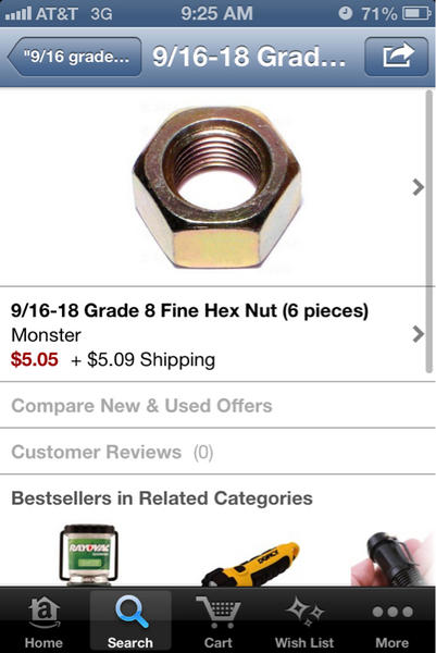

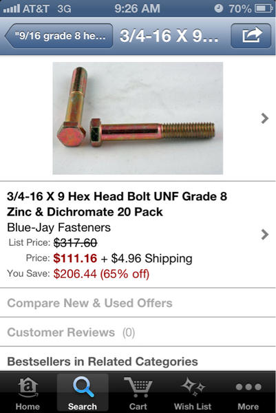

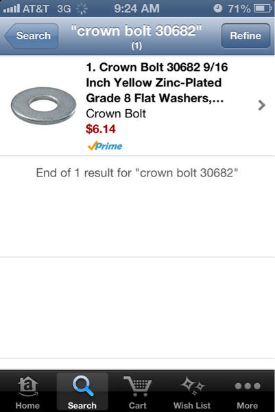

There is a huge post on this subject. Hope this help. Northridge carries a kit if you don't want to purchase them separately
ID:	386958   Click image for larger version
ID:	386959   Click image for larger version

Price is high cuz of the quantity just sent the pics for an image of the bolts
