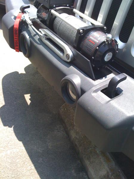

Some of us have taken matters into our own hands and used a TJ plate to mount a winch into the stock bumper. All it takes is a drill, an angle grinder an appropriate repertoire of curse words to make it happen. Here's a link to the write up thread.
Winch mount w/factory bumper
And my own installation details within that same thread:
Geko's winch install
And here is what the finished product looked like!
Thanks. That looks damn good.

Check out this thread. It gives great detail on how to make a stubby out of your stock bumper and how to install the winch plate. Read to the bottom of page 1 and you will see an ebay item number for a winch plate made specifically for the JK. It's $99 plus shipping and does not require any drilling/cutting since it's made for the JK.
The stubby process is rather straight forward and easy; just remember not to cut off the integrated nuts that hold the plastic cover to the bumper (taping the outline took the longest due to the angles in the plastic; remember to tape straight and NOT follow the angles of the molded plastic).
I did mine (before buying a new bumper). The only thing I did different was NOT using the rivots. I simpy took a soldering torch with a chisel head and melted the plastic back together for a cleaner look (easier than the rivots too)!
Hope this helps. You can get the winch plate and make the simple mods without fabing a stubby if you prefer.

my homemade stubby/winch mount

Here is my setup. I went the TJ mount route. I have since swapped out the cable with rope.
