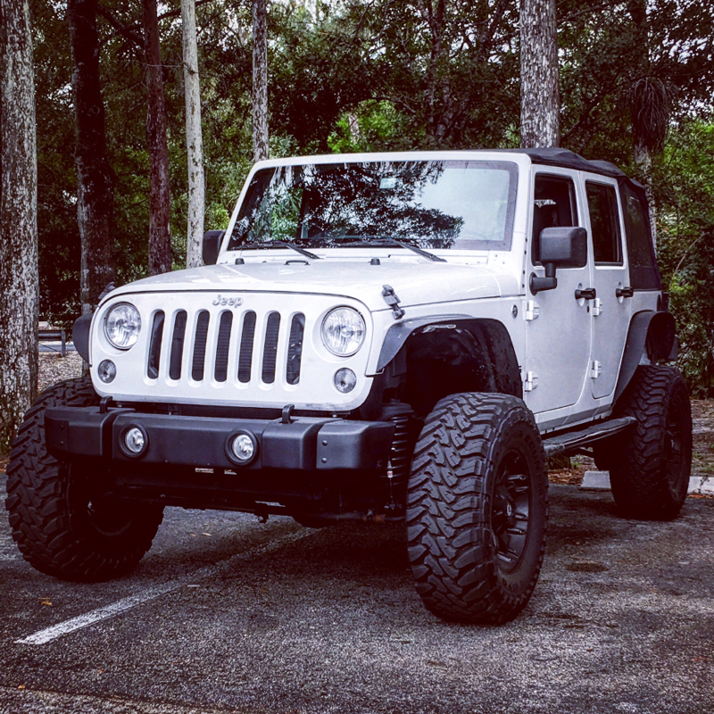

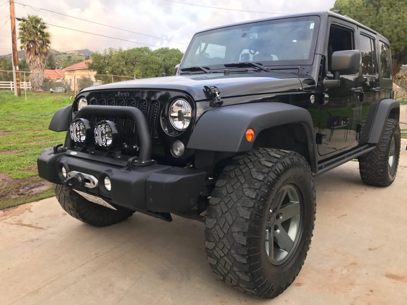

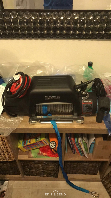

Been searching the forum and looking at google. I want to know the best way to mount my winch to my frame and put my factory bumper back over it. I like the inside look. I just don't think my winch will fit inside. I want it to look clean. I'm a minimalist. Thanks.

I think those guys run a remote solenoid location... Your winch seems to have an integrated one which is why it appears it won't fit under there... Maybe since they get mounted upside down it will still fit if the sway bar isn't too much in the way.

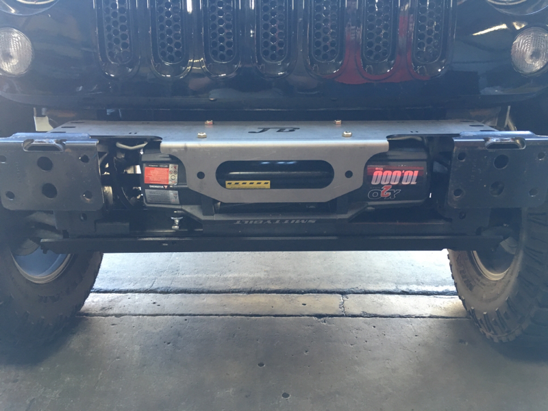

Smittybuilt X20 w/ synthetic line and remote solenoid. It's a tight fit and there is a good bit of fabrication work, but the result is nice

that's exactly what I want to do. How much fab we talking?which winch plate did you use?
